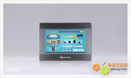

  TK6070iQ£¬ÊǼÌWEINVIEW TK6070iPÖ®ºóµÄÁ¿²úÐͲúÆ·£¬ Ëü¼¯³ÉÁËUSB Host½Ó¿Ú£¬¿ÉÍâ½ÓUÅÌ£¬ÉÏ´«ÏÂÔØ³ÌÐò¸ü¼Ó±ã½Ý£¬ÌرðÊÊÓÃÓÚ×°Åäµ÷ÊÔ´óÁ¿»úÆ÷É豸ʱ£¬ÏÂÔØ³ÌÐòÎÞÐèͨ¹ýUSBÏßÀÂÁ¬½ÓµçÄÔ£¬Ö±½Óͨ¹ýUÅ̼´¿É£¬´ó´óÌá¸ßµçÆøµ÷ÊÔЧÂÊ¡£´ËÍ⣬USB Host½Ó¿Ú»¹¿ÉÍâ½Ó¼üÅÌ¡¢Êó±êµÈUSB×°Öã¬Á¬½Ó¸ü¼Ó¶àÑù»¯£¬ÊÊÓÃÐÔ¸ü¹ã¡£
