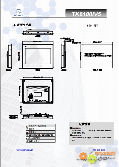

²úÆ·Ãû³Æ£º ÍþÂÚͨÈË»ú½çÃæ´¥ÃþÆÁTK6100iV5
ÐÍ ºÅ£º TK6100iV5
¹ãÖÝÁúºë×Ô¶¯»¯É豸ÓÐÏÞ¹«Ë¾-ÈçÓÐÐèÒªÇëÁªÏµÂô¼Ò
ÏÔʾ
ÏÔʾÆ÷
10” TFT
·Ö±æÂÊ
800 x 480
ÁÁ¶È
300
¶Ô±È¶È
500:01:00
±³¹âÀàÐÍ
LED
±³¹âÊÙÃü
30,000Сʱ
ÏÔʾɫ²Ê
65536
´¥¿ØÃæ°å
ÀàÐÍ
4ÏßÄ£Äâµç×èʽ
´¥¿Ø¾«¶È
Active Area Length(X)±2%, Width(Y)±2%
´æ´¢Æ÷
ÉÁ´æ (Flash)
128 MB
ÄÚ´æ(RAM)
64 MB
´¦ÀíÆ÷
32Bit RISC 400MHz
I/O½Ó¿Ú
SD ¿¨²å²Û
ÎÞ
USB Host
ÎÞ
USB Client
USB 2.0 x 1
ÒÔÌ«Íø½Ó¿Ú
ÎÞ
´®Ðнӿڠ
Com1: RS-232/RS-485 2w/4w, Com3 RS-485 2w
ÉùÒôÊä³ö
ÎÞ
ÍòÄêÀú
ÄÚÖà
µçÔ´
ÊäÈëµçÔ´
24±20%VDC
µçÔ´¹¦ºÄ
300mA@24VDC
µçÔ´¸ôÀë
ÄÚÖà
Ä͵çѹ
500VAC  (1·ÖÖÓ)
¾øÔµ×迹
³¬¹ý50MΩ@500VDC
¿¹Õ𶯠
10 to 25Hz(X,Y,Z ·½Ïò 2G30·ÖÖÓ)
¹æ¸ñ
Íâ¿Ç²ÄÖÊ
¹¤³ÌËÜÁÏ
ÍâÐγߴç WxHxD
271 x 213 x 40mm
¿ª¿×³ß´ç
260 x 202mm
ÖØÁ¿
Ô¼1.3 kg
²Ù×÷»·¾³
·À»¤µÈ¼¶
NEMA4 / IP65
´¢´æ»·¾³Î¶Ƞ
-20°~60°C(-4° ~140°F)
ʹÓû·¾³Î¶Ƞ
0° ~50°C(32° ~122°F)
ʹÓû·¾³Êª¶È
10% ~ 90% @40°C, ÎÞÀäÄý
CEÈÏÖ¤
·ûºÏCEÈÏÖ¤±ê×¼
ʹÓÃÈí¼þ
ÏÞÓÚ¼òÌåÖÐÎİæEB8000 V4.42»ò¸üР
²úÆ·ÌØµã
10" 800x480 TFT LCD
ÎÞ·çÉÈÀäȴϵͳ
ÄÚ½¨´¢´æÄÚ´æ¼°ÍòÄêÀú
NEM A4/IP65 Ãæ°å·À»¤µÈ¼¶
LED ±³¹âµÆ
ÄÚ½¨µçÔ´¸ôÀë·À»¤Æ÷
Com1¼°Com3µÄ ¡¾RS485¡¿2W Ö§³Ö MPI 187.5K,µ«Í¬Ê±¼äÖ»ÄÜÔñһʹÓÃ
