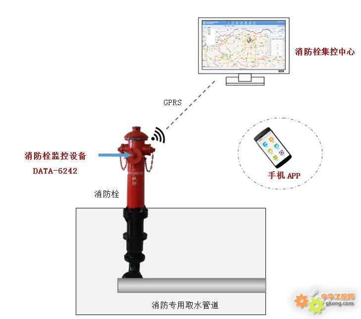

Ïû·À˨¼à¿ØÉ豸ÎÞÐè¸Ä±äÔ­ÓÐÏû·À˨½á¹¹¼´¿É¶ÔÏû·À˨³öˮ״̬½øÐмì²â£¬²¢½«³öË®±¨¾¯ÐÅϢͨ¹ýGPRSÔ¶´«¸ø¼¯¿ØÖÐÐÄ£¬ÊµÏÖÁËÏû·À˨µÄ¼¯Öмà¹Ü£»Í¬Ê±¿É¸ù¾ÝÐèÒª¶Ô¹ÜµÀѹÁ¦½øÐмà²â¡£

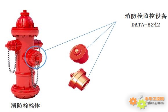

Ïû·À˨һ°ãÓÐ2-3¸ö³öË®¿Ú£¬³öË®¿ÚÖ±¾¶Îª65mmÓë100mmÁ½ÖÖ¡£ÆäÖÐ65mm³öË®¿ÚÓÃÓÚÁ¬½ÓÏû·À´ø£¬100mm³öË®¿ÚרÃÅÓÃÓÚ¸øÏû·À³µÁ¾²¹Ë®¡£³£¹æÇé¿öÏ£¬ËùÓгöË®¿Ú¶¼¸ÇÓÐÃÆ¸Ç£¬·Àֹ©ˮ£¬Ê¹ÓÃÄĸö³öË®¿Ú¾Í°Ñ¶ÔÓ¦µÄÃÆ¸ÇÅ¡¿ª¡£
Ïû·À˨¼à¿ØÉ豸°²×°¿Ú¾¶Îª100mm£¬ÓÃÓÚÌæ»»Ô­ÓÐ100mm³öË®¿ÚÃÆ¸Ç¡£

   1¡¢µ±ÓÐÈËÔÚ100mm³öË®¿ÚÓÃË®£¬ÔÚÅ¡¶¯Ïû·À˨¼à¿ØÉ豸ʱ£¬×°ÖÃÖеÄÇãб¿ª¹Ø·¢ÉúλÖÃÆ«Àë²¢µ¼Í¨£¬´¥·¢Ïû·À˨¼à¿ØÉ豸½«±¨¾¯ÐÅϢͨ¹ýGPRSÔ¶´«ÖÁ¼¯¿ØÖÐÐÄ£¬ÊµÏÖ¼°Ê±±¨¾¯¡£
  1. µ±ÓÐÈËÔÚ65mm³öË®¿ÚÓÃË®£¬³öË®ºóÏû·À˨ÄÚµÄˮѹ´¥·¢Ïû·À˨¼à¿ØÉ豸ÄÚµÄ΢¶¯¿ª¹Ø±ÕºÏ£¬Í¬Ñù´¥·¢¸Ã×°Öý«±¨¾¯ÐÅÏ¢Ô¶´«ÖÁ¼¯¿ØÖÐÐÄ¡£
3¡¢Ïû·À˨¼à¿ØÉ豸Å䱸À¶ÑÀͨÐŹ¦ÄÜ£¬ÊµÏÖͨ¹ýÊÖ»úAPP¶ÔÆä½øÐÐÎÞÏßά»¤¡£
À©Õ¹Ó¦Óãº
Ïû·À˨¼à¿ØÉ豸»¹Å䱸433MHzÎÞÏßͨÐŹ¦ÄÜ£¬ÓÃÀ´À©Õ¹¼à²âÏû·À¹ÜµÀѹÁ¦¡£
ÔÚÏû·À˨ÒÇ±í¾®ÄÚ°²×°433MHz΢¹¦ºÄ²â¿ØÖն˲ɼ¯¹ÜµÀѹÁ¦£¬½«Ñ¹Á¦Êý¾Ý´«ÊäÖÁÏû·À˨¼à¿ØÉ豸ÉÏ£¬ÔÙ¶¨Ê±Í¨¹ýGPRS´«ÊäÖÁ¼¯¿ØÖÐÐÄ¡£
