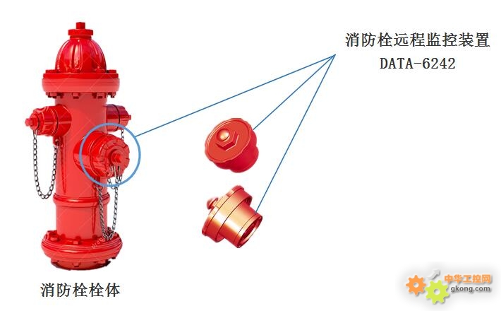

Ïû·À˨ÖÇÄÜÃÆ¸ÇÎÞÐè¸Ä±äÔ­ÓÐÏû·À˨½á¹¹¼´¿É¶ÔÏû·À˨³öˮ״̬½øÐмì²â£¬²¢½«³öË®±¨¾¯ÐÅϢͨ¹ýGPRSÔ¶´«¸ø¼¯¿ØÖÐÐÄ£¬ÊµÏÖÁËÏû·À˨µÄ¼¯Öмà¹Ü£»Í¬Ê±¿É¸ù¾ÝÐèÒª¶Ô¹ÜµÀѹÁ¦½øÐмà²â¡£
Ïû·À˨ÖÇÄÜÃÆ¸ÇÓÉÌÆÉ½Æ½Éýµç×Ó¼¼Êõ¿ª·¢ÓÐÏÞ¹«Ë¾×ÔÖ÷Ñз¢£¬ÒÑÉêÇë¹ú¼ÒרÀû¡£
Ïû·À˨һ°ãÓÐ2-3¸ö³öË®¿Ú£¬³öË®¿ÚÖ±¾¶Îª65mmÓë100mmÁ½ÖÖ¡£ÆäÖÐ65mm³öË®¿ÚÓÃÓÚÁ¬½ÓÏû·À´ø£¬100mm³öË®¿ÚרÃÅÓÃÓÚ¸øÏû·À³µÁ¾²¹Ë®¡£³£¹æÇé¿öÏ£¬ËùÓгöË®¿Ú¶¼¸ÇÓÐÃÆ¸Ç£¬·Àֹ©ˮ£¬Ê¹ÓÃÄĸö³öË®¿Ú¾Í°Ñ¶ÔÓ¦µÄÃÆ¸ÇÅ¡¿ª¡£
Ïû·À˨ÖÇÄÜÃÆ¸Ç°²×°¿Ú¾¶Îª100mm£¬ÓÃÓÚÌæ»»Ô­ÓÐ100mm³öË®¿ÚÃÆ¸Ç¡£

ͨÐÅ·½Ê½£ºGPRS¡¢433MHz¡¢À¶ÑÀ¡£
°²×°¿Ú¾¶£ºφ100mm¡£
¹©µç·½Ê½£ºµç³Ø¹©µç£¨2½Ú¸ßÄÜÁ¿ï®µç³Ø£¬µç³ØÈÝÁ¿£º14AH£©¡£
µç³ØÊÙÃü£º2-5Äê¡£
·ÀË®µÈ¼¶£ºIP68¡£
¹¤×÷ζȣº-40 ~ +85¡æ¡£
Íâ¿Ç²ÄÖÊ£º¸ßÇ¿¶ÈÄáÁú¡£
¡¾²úÆ·Ó¦Óá¿
  1. µ±ÓÐÈËÔÚ100mm³öË®¿ÚÓÃË®£¬ÔÚÅ¡¶¯Ïû·À˨·ÀµÁË®±¨¾¯×°ÖÃʱ£¬×°ÖÃÖеÄÇãб¿ª¹Ø·¢ÉúλÖÃÆ«Àë²¢µ¼Í¨£¬´¥·¢Ïû·À˨·ÀµÁË®±¨¾¯×°Öý«±¨¾¯ÐÅϢͨ¹ýGPRSÔ¶´«ÖÁ¼¯¿ØÖÐÐÄ£¬ÊµÏÖ¼°Ê±±¨¾¯¡£
  2. µ±ÓÐÈËÔÚ65mm³öË®¿ÚÓÃË®£¬³öË®ºóÏû·À˨ÄÚµÄˮѹ´¥·¢Ïû·À˨·ÀµÁË®±¨¾¯×°ÖÃÄÚµÄ΢¶¯¿ª¹Ø±ÕºÏ£¬Í¬Ñù´¥·¢¸Ã×°Öý«±¨¾¯ÐÅÏ¢Ô¶´«ÖÁ¼¯¿ØÖÐÐÄ¡£
  3. ÌÆÉ½Æ½ÉýÏû·À˨ÖÇÄÜÃÆ¸ÇÅ䱸À¶ÑÀͨÐŹ¦ÄÜ£¬ÊµÏÖͨ¹ýÊÖ»úAPP¶ÔÆä½øÐÐÎÞÏßά»¤¡£
À©Õ¹Ó¦Óãº
Ïû·À˨ÖÇÄÜÃÆ¸ÇDATA-6242»¹Å䱸433MHzÎÞÏßͨÐŹ¦ÄÜ£¬ÓÃÀ´À©Õ¹¼à²âÏû·À¹ÜµÀѹÁ¦¡£
ÔÚÏû·À˨ÒÇ±í¾®ÄÚ°²×°433MHz΢¹¦ºÄ²â¿ØÖն˲ɼ¯¹ÜµÀѹÁ¦£¬½«Ñ¹Á¦Êý¾Ý´«ÊäÖÁÏû·À˨ÖÇÄÜÃÆ¸ÇÉÏ£¬ÔÙ¶¨Ê±Í¨¹ýGPRS´«ÊäÖÁ¼¯¿ØÖÐÐÄ¡£
