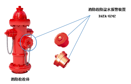

Ïû·À˨һ°ãÓÐ2-3¸ö³öË®¿Ú£¬³öË®¿ÚÖ±¾¶Îª65mmÓë100mmÁ½ÖÖ¡£ÆäÖÐ65mm³öË®¿ÚÓÃÓÚÁ¬½ÓÏû·À´ø£¬100mm³öË®¿ÚרÃÅÓÃÓÚ¸øÏû·À³µÁ¾²¹Ë®¡£³£¹æÇé¿öÏ£¬ËùÓгöË®¿Ú¶¼¸ÇÓÐÃÆ¸Ç£¬·Àֹ©ˮ£¬Ê¹ÓÃÄĸö³öË®¿Ú¾Í°Ñ¶ÔÓ¦µÄÃÆ¸ÇÅ¡¿ª¡£

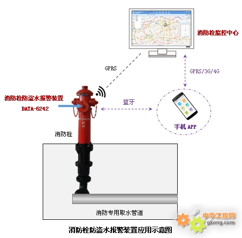

ÎÒÃǵÄÏû·À˨·ÀµÁË®±¨¾¯×°ÖÃÖ±½ÓÌæ»»Ô­ÓÐ100mm³öË®¿ÚÃÆ¸Ç£¬²¢²»¸Ä±äÏû·À˨Íâ¹Û ¡£
Ô­Àí£º
1¡¢µ±ÓÐÈËÔÚ100mm³öË®¿ÚÓÃË®£¬ÔÚÅ¡¶¯Ïû·À˨·ÀµÁË®±¨¾¯×°ÖÃʱ£¬×°ÖÃÖеÄÇãб¿ª¹Ø·¢ÉúλÖÃÆ«Àë²¢µ¼Í¨£¬´¥·¢Ïû·À˨·ÀµÁË®±¨¾¯×°Öý«±¨¾¯ÐÅϢͨ¹ýGPRSÔ¶´«ÖÁ¼à¿ØÖÐÐÄ£¬ÊµÏÖ¼°Ê±±¨¾¯¡£
   2¡¢µ±ÓÐÈËÔÚ65mm³öË®¿ÚÓÃË®£¬³öË®ºóÏû·À˨ÄÚµÄˮѹ´¥·¢Ïû·À˨·ÀµÁË®±¨¾¯×°ÖÃÄÚµÄ΢¶¯¿ª¹Ø±ÕºÏ£¬Í¨¹ýGPRS½«±¨¾¯ÐÅÏ¢Ô¶´«ÖÁ¼à¿ØÖÐÐÄ£¬ÊµÏÖ±¨¾¯¡£
   3¡¢Ïû·À˨·ÀµÁË®±¨¾¯×°ÖÃÅ䱸À¶ÑÀͨÐŹ¦ÄÜ£¬ÊµÏÖͨ¹ýÊÖ»úAPP¶ÔÆä½øÐÐÎÞÏßά»¤£¬²¢ÇÒÊÖ»úAPPÄܹ»ËæÊ±²é¿´±¨¾¯ÐÅÏ¢£¬È·¶¨Ïû·À˨λÖá£
4¡¢¹©µç·½Ê½²ÉÓÃµç³Ø¹©µç£¬ÊÙÃü2-5Ä꣬²ÄÖÊʹÓøßÇ¿¶ÈÄáÁú¡£
Îå¡¢Ïû·À˨·ÀµÁË®±¨¾¯×°ÖõÄÓ¦ÓÃÇé¿ö
Ŀǰ£¬ÌÆÉ½Æ½ÉýÑз¢µÄÏû·À˨·ÀµÁË®±¨¾¯×°Öã¬ÒѾ­ÔÚijˮ˾µÃµ½Ó¦Óã¬ÔËÐÐÒÔÀ´£¬Îȶ¨¡¢¿É¿¿£¬ÎÞÂÛ¶àÔ¶¶¼Äܼà²âµ½Î»£¬Ò»µ©·¢ÉúµÁË®Çé¿ö£¬¶¼Äܼ°Ê±±¨¾¯£¬µÚһʱ¼ä´¦Àí¡£Êµ¼ùÖ¤Ã÷ÕâÏî²úÆ·ÊÇÄܹ»°ïÖúˮ˾½â¾öÏû·À˨¹ÜÀíÎÊÌâµÄ¡£
