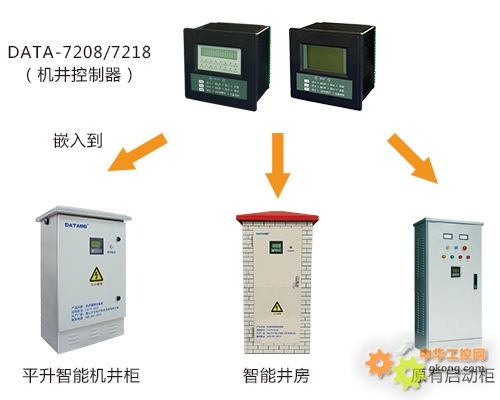

      É䯵¿¨ÖÇÄÜ¿ØÖÆÆ÷DATA-7208/7218£¬¿ÉÒÔǶÈ뵽ƽÉýÖÇÄÜ»ú¾®¹ñ¡¢ÖÇÄܾ®·¿»òÔ­ÓÐÆô¶¯¹ñ£¬¶Ô»ú¾®½øÐÐ¼à¿Ø¡£

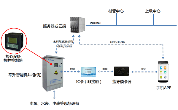

      ƽÉý¶À´´À¶ÑÀÉ豸ά»¤¹¦ÄÜ¡£É䯵¿¨ÖÇÄÜ¿ØÖÆÆ÷ͨ¹ýÀ¶ÑÀÍøÂçÓëÊÖ»úAPP½ü¾àÀëÁ¬½Ó¡£¿ÉÒÔʵÏÖ¿ØÖÆÆ÷ÎÞÏßÉý¼¶£¬¿ØÖÆÆ÷µÄÎÞÏßά»¤£¬»ú¾®Êý¾ÝµÄͬ²½ÉÏ´«¡£
ϵͳ½á¹¹ËµÃ÷
1¡¢½«Ç¶ÈëDATA-7218µÄƽÉý»ú¾®¿ØÖƹñÓëÏÖ³¡É豸¶Ô½Ó¡£
2¡¢ ÈÎÒâÒ»²¿°²×°ÁË»ú¾®¹ÜÀíAPPµÄ°²×¿ÊÖ»ú£¬Í¨¹ýÁ¬½ÓÀ¶ÑÀ¶Á¿¨Æ÷£¬¶ÔIC¿¨½øÐпª¿¨¡¢³äÖµµÄ¹ÜÀí£¬ÓÃË®»§¿Éͨ¹ý¼òµ¥µÄË¢¿¨Á÷³Ì£¬²Ù×÷¹à¸È»ú¾®È¡Ë®£¬Í£Ö¹È¡Ë®Ê±¸ù¾ÝË®Á¿¡¢µçÁ¿¿Û³ýÏà¹Ø·ÑÓá£
3¡¢»ú¾®¿ØÖÆÆ÷ÓëÊÖ»ú¾ù¿ÉÒÔͨ¹ýGPRS¡¢3G»ò4GÍøÂçÓëÖÐÐÄ·þÎñÆ÷ͬ²½Í¨Ñ¶¡£
4¡¢´å¼¶ÖÐÐÄÓëÉϼ¶¹ÜÀíÖÐÐÄÄÜÔ¶³Ì·ÃÎÊ·þÎñÆ÷£¬È¡µÃ²¢¹ÜÀíÏà¹ØÊý¾Ý¡£
