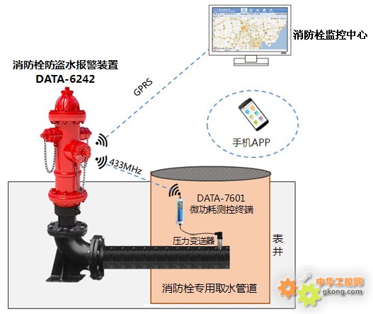

Îå¡¢ÖÇ»ÛÏû·À˨¸Çñ¡¢ÖÇ»ÛÏû·ÀË¨ÃÆ¸Ç——Ïû·À˨·ÀµÁË®±¨¾¯×°Öõļ¼Êõ¼ò½é
1. ²úÆ·½éÉÜ
Ïû·À˨·ÀµÁË®±¨¾¯×°ÖÃDATA-6242
1)²»¸Ä±äÏû·À˨Íâ¹Û£¬Ö±½ÓÌæ»»Ô­ÓÐ100mm³öË®¿ÚÃÆ¸Ç¡£
2)ͨ¹ýGPRS/CDMA½«±¨¾¯ÐÅÏ¢¼°Êý¾ÝÔ¶´«¸ø¼à¿ØÖÐÐÄ¡£
2.Ö÷Òª¹¦ÄÜ£º
3.¼¼Êõ²ÎÊý
ͨÐÅ·½Ê½£ºGPRS/CDMA¡¢433MHz¡¢À¶ÑÀ¡£
°²×°¿Ú¾¶£ºφ100mm¡£
¹©µç·½Ê½£ºµç³Ø¹©µç¡£
µç³ØÊÙÃü£º2-5Äê¡£
·ÀË®µÈ¼¶£ºIP68¡£
¹¤×÷ζȣº-40 ~ +85¡æ¡£
Íâ¿Ç²ÄÖÊ£º¸ßÇ¿¶ÈÄáÁú¡£
Áù¡¢ÖÇÄÜÏû·À˨µÄ¼à²âÔ­Àí
Ïû·À˨·ÀµÁË®±¨¾¯×°ÖÃÓ¦ÓÃʾÒâͼ1
1) µ±ÓÐÈËÔÚ100mm³öË®¿ÚÓÃË®£¬ÔÚÅ¡¶¯Ïû·À˨·ÀµÁË®±¨¾¯×°ÖÃʱ£¬×°ÖÃÖеÄÇãб¿ª¹Ø·¢ÉúλÖÃÆ«Àë²¢µ¼
ͨ£¬´¥·¢±¨¾¯×°Ö㬽«±¨¾¯ÐÅϢͨ¹ýGPRSÔ¶´«ÖÁ¼à¿ØÖÐÐÄ£¬ÊµÏÖ¼°Ê±±¨¾¯¡£
2) µ±ÓÐÈËÔÚ65mm³öË®¿ÚÓÃË®£¬³öË®ºóÏû·À˨ÄÚµÄˮѹ´¥·¢Ïû·À˨·ÀµÁË®±¨¾¯×°ÖÃÄÚµÄ΢¶¯¿ª¹Ø±ÕºÏ£¬
ͨ¹ýGPRS½«±¨¾¯ÐÅÏ¢Ô¶´«ÖÁ¼à¿ØÖÐÐÄ£¬ÊµÏÖ±¨¾¯¡£
3) Ïû·À˨·ÀµÁË®±¨¾¯×°ÖÃÅ䱸À¶ÑÀͨÐŹ¦ÄÜ£¬ÊµÏÖͨ¹ýÊÖ»úAPP¶ÔÆä½øÐÐÎÞÏßά»¤£¬²¢ÇÒÊÖ»úAPPÄܹ»
ËæÊ±²é¿´±¨¾¯ÐÅÏ¢£¬È·¶¨Ïû·À˨λÖá£
Æß¡¢ÖÇÄÜÏû·À˨µÄÍØÕ¹Ó¦ÓÃ
 Ïû·À˨·ÀµÁË®±¨¾¯×°ÖÃÓ¦ÓÃʾÒâͼ2
1)Ïû·À˨·ÀµÁË®±¨¾¯×°Öû¹Å䱸433MHzÎÞÏßͨÐŹ¦ÄÜ£¬ÓÃÀ´À©Õ¹¼à²âÏû·À¹ÜµÀѹÁ¦¡£
2)±í¾®ÄÚ°²×°433MHz΢¹¦ºÄ²â¿ØÖն˲ɼ¯¹ÜµÀѹÁ¦£¬½«Ñ¹Á¦Êý¾Ý´«ÊäÖÁÏû·À˨·ÀµÁË®±¨¾¯×°ÖÃÉÏ£¬ÔÙ¶¨
ʱͨ¹ýGPRS´«ÊäÖÁ¼¯¿ØÖÐÐÄ¡£
