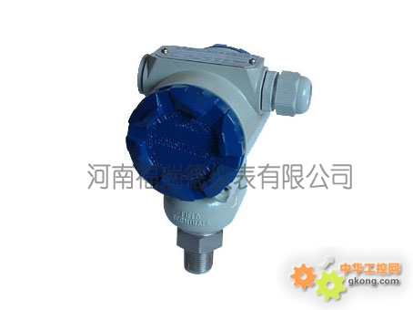

ÐÍ ºÅ£º FRD8054
FRD-8054ϵÁÐѹÁ¦±äËÍÆ÷
Ò»¡¢¸ÅÊö
±¾ÏµÁÐѹÁ¦±äËÍÆ÷Ñ¡Óýø¿Ú¸ßÆ·Öʽø¿ÚѹÁ¦´«¸ÐÆ÷,²ÉÓÃרÓü¯³ÉÄ£¿é,¾­¾«Ï¸µÄζȡ¢Áãµã¡¢ÂúÁ¿³Ì¡¢ºÍ·ÇÏßÐÔ²¹³¥£¬ÊµÏÖ¶ÔÒºÌå¡¢ÆøÌå¡¢ÕôÆûµÈ½éÖÊѹÁ¦±ä»¯µÄ׼ȷ²âÁ¿ºÍ±äËÍ¡£¸£ÈðµÂ·À±¬¸ß¾«¶ÈѹÁ¦±äËÍÆ÷³§¼Ò¸£ÈðµÂ·À±¬¸ß¾«¶ÈѹÁ¦±äËÍÆ÷³§¼Ò¸£ÈðµÂ·À±¬¸ß¾«¶ÈѹÁ¦±äËÍÆ÷³§¼Ò
FRD-8054ϵÁÐѹÁ¦±äËÍÆ÷²ÉÓÃÃÀ¹úICϵÁÐÀ©É¢¹èѹÁ¦´«¸ÐÆ÷£»±ê×¼ÐÍFRD-8054A£¬Ð¡ÇÉÐÍFRD-8054BѹÁ¦±äËÍÆ÷²ÉÓýø¿Ú¹èѹ×èѹÁ¦´«¸ÐÆ÷£»FRD-8054CϵÁÐѹÁ¦±äËÍÆ÷²ÉÓõ¹úE+H¹«Ë¾µÄÌմɵçÈÝѹÁ¦´«¸ÐÆ÷£¬Î¶ȷ¶Î§¿í£¬³¤ÆÚÎȶ¨ÐԺá£
ȫϵÁÐѹÁ¦±äËÍÆ÷¶¼¿ÉÒÔ´øHARTͨѶ¡¢485ͨѶ¡¢CAN×ÜÏßͨѶ£¬²¢¿ÉѡװLED¡¢LCD±íÍ·¡£Í¨¹ýPC»ú»òÊÖ²ÙÆ÷£¨Í¨Ñ¶Æ÷£©¿ÉÒÔÔÚÏÖ³¡»ò¿ØÖÆÊҶԸñäËÍÆ÷½øÐÐÔ¶³Ì¿ØÖÆ»òϵͳ×é̬¡£
±¾ÏµÁвúÆ·ÓжàÖÖ½Ó¿ÚÐÎʽ£¬Æ·ÖÖ¹æ¸ñÆëÈ«£¬Äܹ»×î´óÏ޶ȵØÂú×ã¿Í»§µÄÐèÒª£¬ÌرðÊʺϹ㷺ʹÓÃÓÚ¸÷ÖÖ¹¤ÒµÏÖ³¡¡£
¸ÃϵÁвúÆ··ûºÏGB3836.4-2000¡¶±¬Õ¨ÐÔÆøÌå»·¾³ÓõçÉ豸 µÚ4²¿·Ö ±¾Öʰ²È«ÐÍ“i”¡·ºÍGB3638.1-2000¡¶±¬Õ¨ÐÔÆøÌå»·¾³ÓõçÉ豸 µÚ1²¿·Ö ͨÓÃÒªÇó¡·£¬·À±¬±êÖ¾£ºExia¢òC T6£¬ËüÊÊÓÃÓÚ0Çø¡¢1Çø¡¢2Çø£¬º¬ÓТòA¡«¢òCÀ࣬T1¡«T6×鱬ըÐÔÆøÌå»ìºÏÎïµÄ³¡Ëù£¬²¢¾­¹ú¼Ò·À±¬µçÆø²úÆ·ÖʼìÖÐÐļìÑéºÏ¸ñ£¬È¡µÃ·À±¬Ö¤£¬±àºÅ£ºCNEx08.1964¡£
¶þ¡¢¼¼ÊõÖ¸±ê
·±»²â½éÖÊ£ºÒºÌå¡¢ÆøÌå¡¢ÕôÆû
·²âÁ¿·¶Î§£º-0.1MPA~0~120MPA
·¾«¶ÈµÈ¼¶£º±0.2%FS£¬±0.5%FS
·³¤ÆÚÎȶ¨ÐÔ£º≤0.2%FS/ Äê
·ÎÂ¶ÈÆ¯ÒÆ£º≤0.02% FS / ¡æ£¨ÔÚ0-70 ¡æ·¶Î§ÄÚ£©
·»·¾³Î¶ȣº-20¡æ¡«+60¡æ
·´¢´æÎ¶ȣº-55¡æ¡«+125 ¡æ
·Êä³öÐźţº4-20mA »ò1-5VDC
·¹©µçµçѹ£º12-28VDC
·ÔÊÐí¹ýÔØ£º¶î¶¨Ñ¹Á¦µÄ2 ±¶
·½Óʪ¼þ²ÄÖÊ£º316 ²»Ðâ¸ÖºÍ1Gr18Ni9Ti
·Òýѹ½Ó¿Ú£ºM20×1.5 ÍâÂÝÎÆ
· ·À±¬µÈ¼¶£º±¾°²Exia¢òC T6  ¸ô±¬Exd¢òC T5
· ·À»¤µÈ¼¶£ºIP67
· ±¾°²²ÎÊý£ºUi£º28VDC£¬Ii£º93mA£¬Pi£º0.65W£¬Ci£º0.03uf£¬ Li£º0mH
¹¤×÷Ô­Àí
    ±»²âѹÁ¦Ö±½Ó×÷ÓÃÔÚѹÁ¦´«¸ÐÆ÷ĤƬµÄÇ°Ãæ£¬Ê¹Ä¤Æ¬²úÉú΢СµÄÐα䣬ʹ´«¸ÐÆ÷²úÉúÒ»¸öÓëѹÁ¦³ÉÕý±ÈµÄ¸ß¶ÈÏßÐÔ¡¢Ó뼤ÀøµçѹҲ³ÉÕý±ÈµÄµçѹÐźţ¬´«¸ÐÆ÷Êä³öµÄµçѹÐźž­¹ý²î·Ö¹éÒ»·Å´óÆ÷Êä³ö·Å´óºó£¬ÔÙ¾­¹ýµçѹµçÁ÷µÄת»»£¬±ä»»³ÉÏàÓ¦µÄµçÁ÷Ðźţ¬¸ÃµçÁ÷ÐźÅͨ¹ý·ÇÏßÐÔ½ÃÕý»·Â·µÄ²¹³¥£¬¼´²úÉúÁËÓëÊäÈëѹÁ¦³ÉÏßÐÔ¶ÔÓ¦¹ØÏµµÄ1~ 5V»òÕß4~ 20mA ±ê×¼ÐźÅÊä³ö¡£
