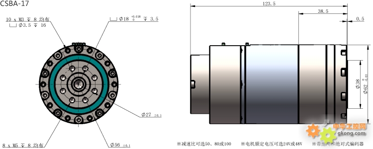

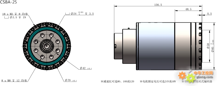

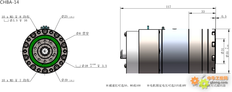

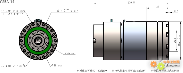

»úе´«¶¯Óëµç»ú²ÎÊý¹æ¸ñ£º
¹æ¸ñ µ¥Î» CHBA-14 CSBA-14 CSBA-17 CSBA-25
¼õËÙ±È   80 80 100 120
ÈÝÐíÆ½¾ùת¾Ø N.m 11 11 39 108
ÈÝÐí×î´óת¾Ø N.m 47 47 108 304
µç»ú¹¦ÂÊ W 100 100 150 400
µç»ú¶î¶¨×ªËÙ rpm 3000 3000 3000 3000
µç»ú×î¸ßתËÙ rpm 5000 5000 5000 5000
µç»ú¶î¶¨×ª¾Ø N.m 0.32 0.32 0.48 1.27
µç»ú¶î¶¨µçѹ VDC 48 48 48 48
µç»ú¶î¶¨µçÁ÷ A 4.5 4.5 4.5 4.5
³Ý϶ arcsec 23 23 10 8
ת¶¯¾«¶È arcmin 2 2 2 2
±³Ï¶ arcmin 1.5 1.5 1.5 1.5
»úе³ß´çÍâÐÎͼ£º
