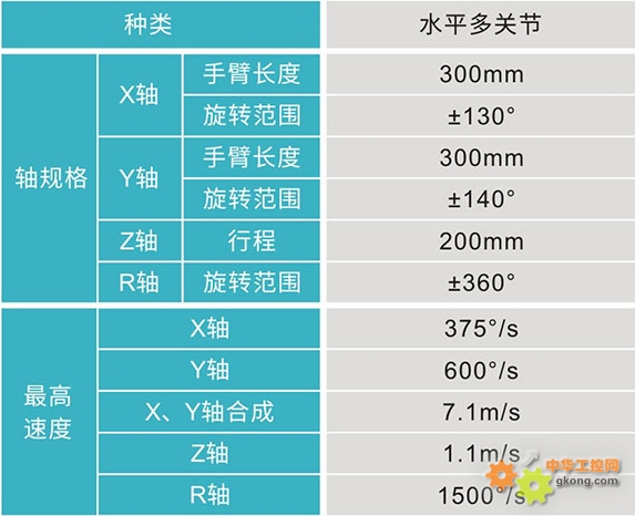

ÖÖÀࣺ¶à¹Ø½ÚÀà
Öá¹æ¸ñ£¨XÖ᣺ÊÖ±Û³¤¶È300mm£¬Ðýת·¶Î§ ±130°£©£¨YÖ᣺ÊÖ±Û³¤¶È300mm£¬Ðýת·¶Î§ ±140°£©£¨ZÖ᣺ÐÐ³Ì 200mm£©£¨RÖ᣺Ðýת·¶Î§ ±360°£©
×î¸ßËÙ¶È£¨XÖá 375°/S  £©£¨YÖá 600°/S  £©£¨X.YÖáºÏ³É  7.1m/s £©£¨ZÖáºÏ³É 1.1m/s £©£¨RÖáºÏ³É  1500°/s £©

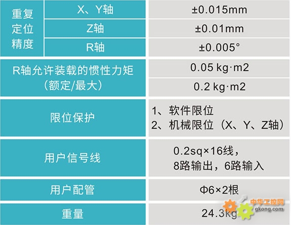

ÖØ¸´¶¨Î»¾«×¼£¨X.YÖá ±0.015mm£© £¨Z Öá ±0.01mm£©£¨R Öá ±0.005°£©
RÖáÔÊÐí×°ÔØµÄ¹ßÐÔÁ¦¾Ø£¨¶î¶¨0.005kg.m2   /    ×î´ó0.02kg.m2£©
ÏÞλ±£»¤£¨1¡¢Èí¼þÏÞλ¡£2¡¢»úеÏÞ루X.Y.ZÖᣩ£©
Óû§ÐźÅÏߣ¨0.2sq  x  16Ïß¡¢8·Êä³ö¡¢6·ÊäÈ룩
Óû§Åä¹Ü£¨Φ 6  X  2  ¸ù£©
ÖØÁ¿£¨24.3KG£©
±ê׼ѭ»·Ê±¼ä£¨¶î¶¨£©£º0.43s
×î´ó¸ºÔØ£º10kg    ¶î¶¨¸ºÔØ£º5kg
ÖØÁ¿£º24.3kg
