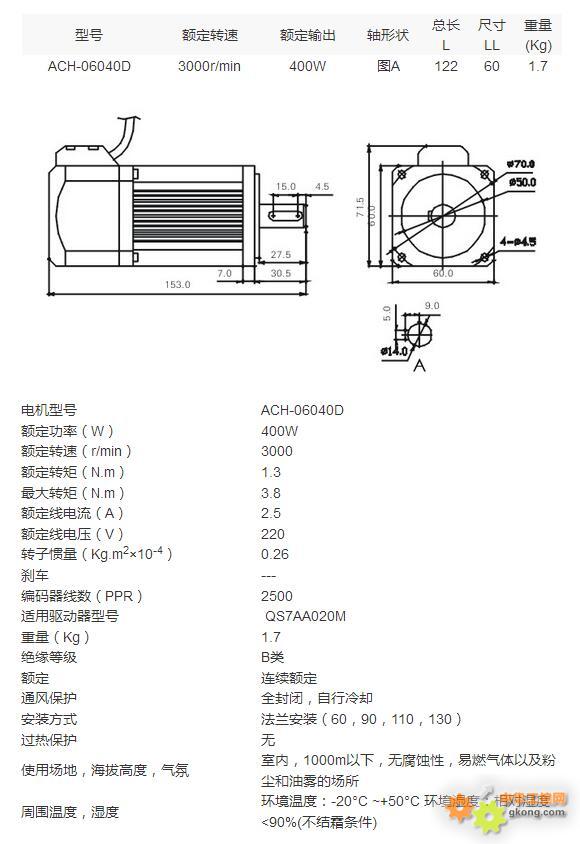

²úÆ·Ãû³Æ£º С¹ßÁ¿ËÅ·þµç»ú ACH-06040D£¨400W£©
ÐÍ ºÅ£º ACH-06040D
С¹ßÁ¿ACH-06040D£¨400W£©¸ßËÙ´óÁ¦¾Ø£»Æ½ÎÈÐԺ㻵ÍÔëÒô£¬µÍÕ𶯣»¸ß¾«¶È£»Íâ¹Û¾«ÃÀ£¬Ò×ÓÚ°²×°£»Æ·Öʱ£Ö¤¡£
ÐͺţºACH-06040D,  ¶î¶¨¹¦ÂÊ£¨W£©£º400W ,  ¶î¶¨×ªËÙ£¨r/min£©£º3000£¬
¶î¶¨×ª¾Ø£¨N.m£©£º1.3£¬×î´óת¾Ø£¨N.m£©£º3.8£¬¶î¶¨ÏßµçÁ÷£¨A£©£º2.5£¬
¶î¶¨Ïßµçѹ£¨V£©£º220£¬×ª×Ó¹ßÁ¿£¨Kg.m²X10--4£©£º0.26£¬±àÂëÆ÷ÏßÊý£¨PPR£©£º2500£¬
ÊÊÓÃÇý¶¯ÐͺţºQS7AA020M,  ÖØÁ¿£¨kg£©1.7£¬ ¾øÔµµÈ¼¶£ºBÀ࣬¶î¶¨£ºÁ¬Ðø¶î¶¨£¬
ͨ·ç±£»¤£ºÈ«·â±Õ¡¢×ÔÐÐÀäÈ´£¬°²×°·½Ê½£º·¨À¼°²×°£¨60¡¢90¡¢110¡¢130£©£¬
ʹÓ󡵨¡¢º£°Î¸ß¶È¡¢Æø·Õ£ºÊÒÄÚ£¬1000mÒÔÏ£¬ÎÞ¸¯Ê´ÐÔ¡¢Ò×È¼ÆøÌåÒÔ¼°·Û³¾ºÍÓÍÎí³¡Ëù£¬ÖÜΧζȡ¢Êª¶È£º»·¾³Î¶È:-20°C¡«+50°C£¬»·¾³Êª¶È£ºÏà¶Ôʪ¶È£¼90%£¨²»½á˪Ìõ¼þ£©¡£
