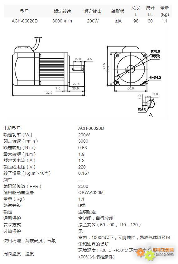

²úÆ·Ãû³Æ£º С¹ßÁ¿ËÅ·þµç»ú ACH-06020D£¨200W£©
ÐÍ ºÅ£º ACH-06020D
С¹ßÁ¿ACH-06020D£¨200W£©¸ßËÙ´óÁ¦¾Ø;ƽÎÈÐԺ㻵ÍÔëÒô£¬µÍÕ𶯣»¸ß¾«¶È£»Íâ¹Û¾«ÃÀ£¬Ò×ÓÚ°²×°£»Æ·Öʱ£Ö¤¡£
ÐͺţºACH-06020D,  ¶î¶¨¹¦ÂÊ£¨W£©£º200W ,  ¶î¶¨×ªËÙ£¨r/min£©£º3000£¬
¶î¶¨×ª¾Ø£¨N.m£©£º0.63£¬×î´óת¾Ø£¨N.m£©£º1.9£¬¶î¶¨ÏßµçÁ÷£¨A£©£º1.2£¬
¶î¶¨Ïßµçѹ£¨V£©£º220£¬×ª×Ó¹ßÁ¿£¨Kg.m²X10--4£©£º0.167£¬±àÂëÆ÷ÏßÊý£¨PPR£©£º2500£¬
ÊÊÓÃÇý¶¯ÐͺţºQS7AA020M,  ÖØÁ¿£¨kg£©1.1£¬ ¾øÔµµÈ¼¶£ºBÀ࣬¶î¶¨£ºÁ¬Ðø¶î¶¨£¬
ͨ·ç±£»¤£ºÈ«·â±Õ¡¢×ÔÐÐÀäÈ´£¬°²×°·½Ê½£º·¨À¼°²×°£¨60¡¢90¡¢110¡¢130£©£¬
ʹÓ󡵨¡¢º£°Î¸ß¶È¡¢Æø·Õ£ºÊÒÄÚ£¬1000mÒÔÏ£¬ÎÞ¸¯Ê´ÐÔ¡¢Ò×È¼ÆøÌåÒÔ¼°·Û³¾ºÍÓÍÎí³¡Ëù£¬ÖÜΧζȡ¢Êª¶È£º»·¾³Î¶È:-20°C¡«+50°C£¬»·¾³Êª¶È£ºÏà¶Ôʪ¶È£¼90%£¨²»½á˪Ìõ¼þ£©¡£
