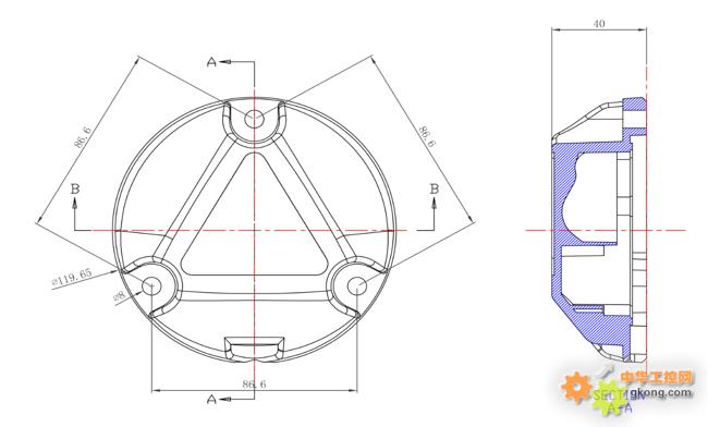

ÍâÐγߴ磺119.65×40mm
·À»¤£ºIP68
¹Ì¶¨¿×¿ª¿×´óС£º8mm
¹Ì¶¨¿×¼ä¾à£º86.6mm

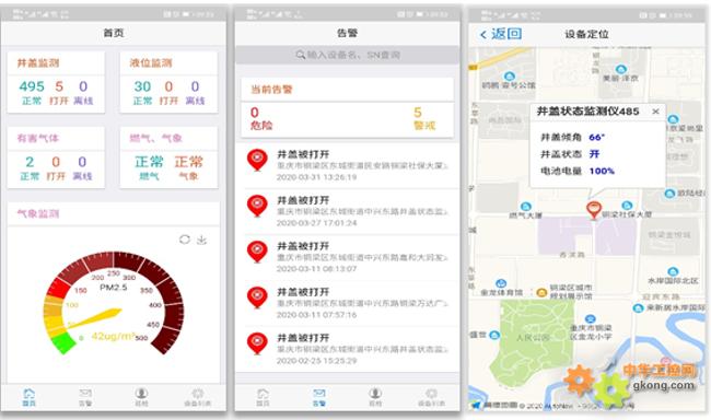

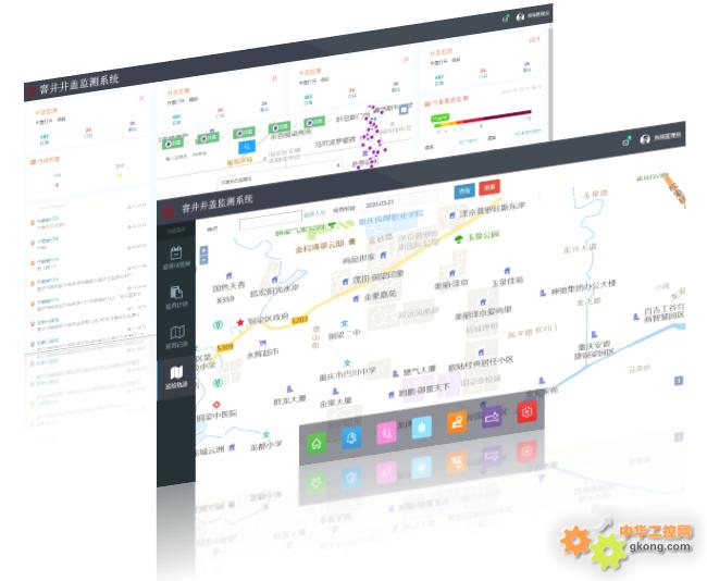

ÅäÌ×Èí¼þ
µçÄÔ¼à²âÈí¼þ
ÊÖ»ú¼à²âÈí¼þ

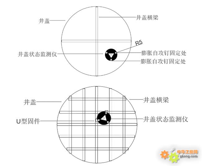

¾®¸Ç״̬¼à²âÒÇÖ§³Ö¶àÖÖ¹æ¸ñ¡¢¶àÖÖ²ÄÖʵľ®¸Ç°²×°£¬³£¼ûµÄ¾®¸Ç´Ó²ÄÁÏÉÏ·ÖΪÖýÌú¾®¸Ç¡¢¸´ºÏ²ÄÁϾ®¸Ç£¬ÓÖ·ÖÎªÍø×´¾®¸Ç¡¢Æ½Ãæ¾®¸Ç2ÖÖÐÎ×´£¬²»Í¬¾®¸ÇµÄ°²×°·½Ê½Èçͼʾ¡£
