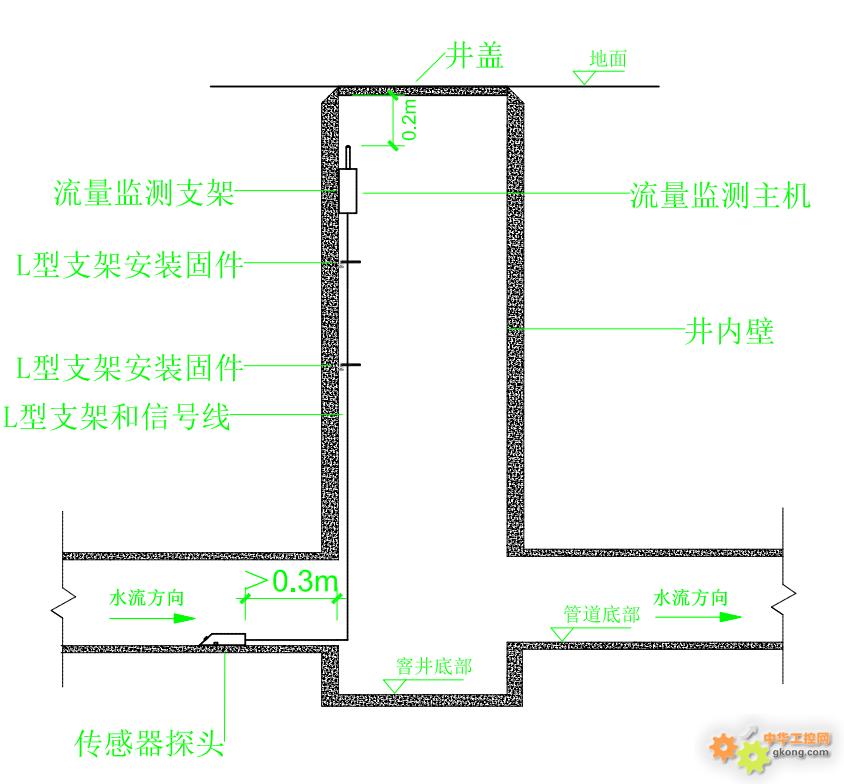

8¡¢°²×°ËµÃ÷
¹ÜµÀÁ÷Á¿¼à²âµãÒ»°ã²¼ÖÃÓÚÖ÷¸É¹Ü¡¢ÖصãÖ§¹Ü¼°¶à¸öÅÅË®Æ¬ÇøµÄ½»»ã´¦£¬ÔÚʵ¼Ê°²×°Á÷Á¿¼ÆµÄ¹ý³ÌÖУ¬Ó¦×ñÑ­ÒÔÏÂÔ­Ôò£º
1.¶àÆÕÀÕÁ÷Á¿¼ÆÓ¦µ±°²×°ÓÚË®ÃæÆ½»ºÎȶ¨¡¢Ã»ÓлØÁ÷ºÍäöÎС¢´¦ÓÚ²âÁ¿·¶Î§ÄÚµÄË®ÃæÎÞÕϰ­ÎïµÈ»·¾³Ï£»
2.¼à²âÕ¾Ó¦±ÜÃâÔÚ¼ì²é¾®½á¹¹¸´ÔÓ¡¢¾®±ÚÊèËɵĹܵÀÄÚ°²×°£¬ÒòΪ¶àÆÕÀÕÁ÷Á¿¼ÆÍ¨¹ý°²×°Ö§¼Ü¹Ì¶¨ÓÚ¼ì²é¾®µÄ¾®±ÚÄÚ£¬¸´ÔÓºÍË𻵵ľ®±Ú½á¹¹»áÔö¼Ó°²×°Ê©¹¤µÄÄѶȣ»
3.Èç¹û±ØÐëÔڹܵÀ½áºÏ´¦¸½½ü°²×°£¬²¢ÇÒÆäÖÐÒ»Ìõ¹ÜµÀÄÚµÄˮλ½Ï¸ß£¬Ó¦µ±½«¶àÆÕÀÕ´«¸ÐÆ÷°²×°ÓڹܵÀµ×²¿£»
4.¶àÆÕÀÕÁ÷ËÙÒÇÕý¶Ô×ÅË®Á÷·½Ïò¡£
³¬Éù²¨¶àÆÕÀÕÁ÷Á¿¼à²âÒǰ²×°Ê¾Òâͼ
