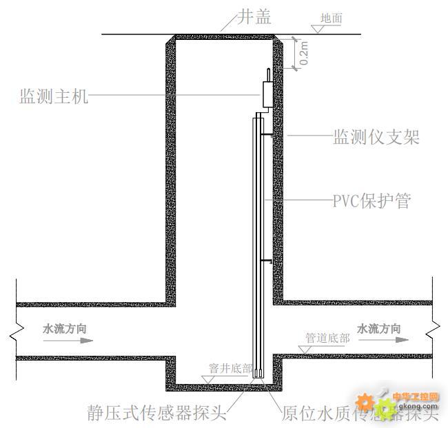

5¡¢Ó¦ÓÃʾÒâͼ

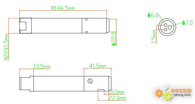

7¡¢ÍâÐγߴç
Íâ¿Ç³ß´ç
Ë®ÖÊ̽ͷ³ß´ç
¾²Ñ¹Ê½Ì½Í·³ß´ç
8¡¢°²×°ËµÃ÷
Ë®Öʼà²âÖ÷»ú²ÉÓñڹÒ+Ö§¼Ü°²×°£¬Ô­Î»Ë®Öʼà²â̽ͷÐè²ÉÓýþÈëʽ°²×°£¬Ë®ÖÊ´«¸ÐÆ÷ÓëÖ÷»úͨ¹ý¿¹¸ÉÈÅÄÜÁ¦Ç¿µÄÐźÅÏßÀÂÁ¬½Ó¡£
