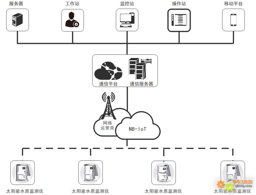

5¡¢Ó¦ÓÃʾÒâͼ

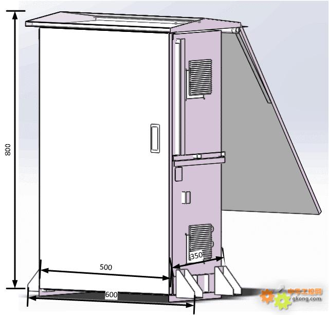

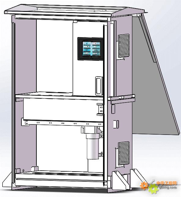

7¡¢ÍâÐγߴç

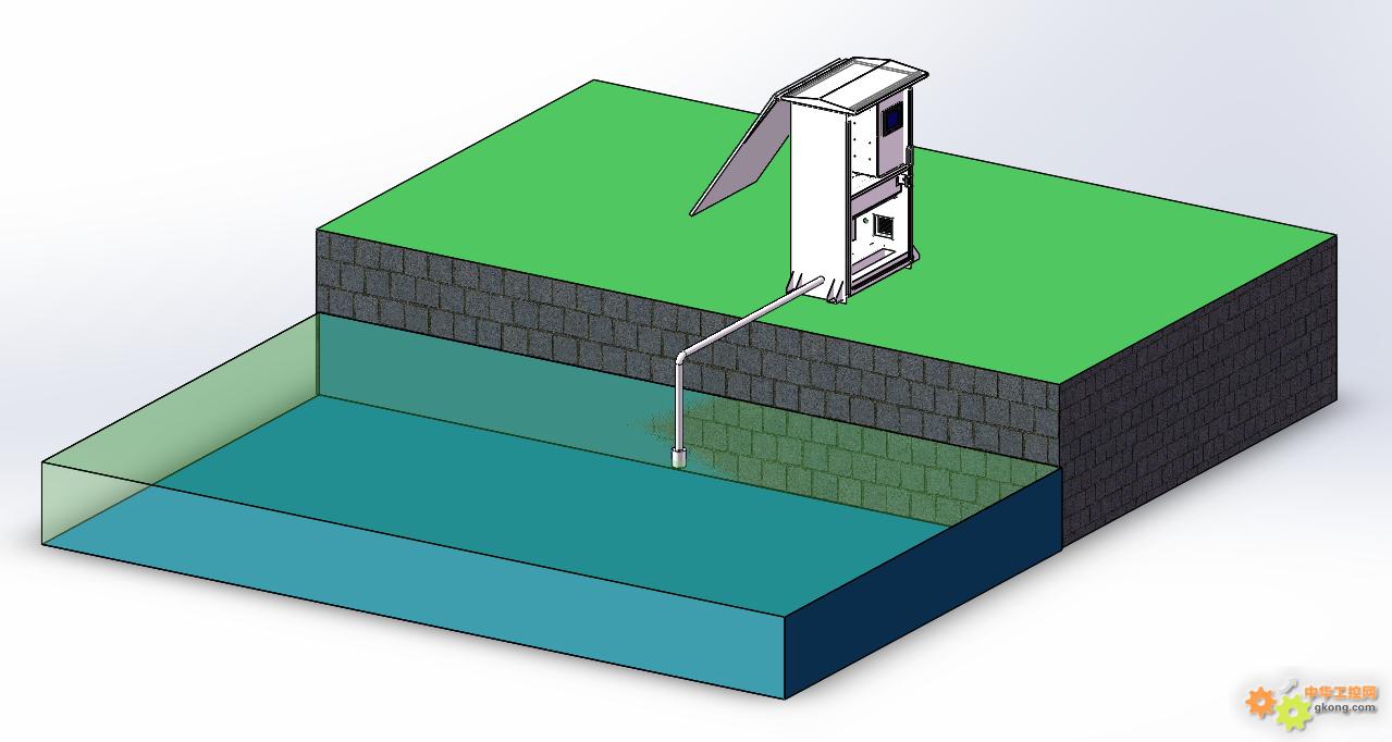

8¡¢°²×°ËµÃ÷

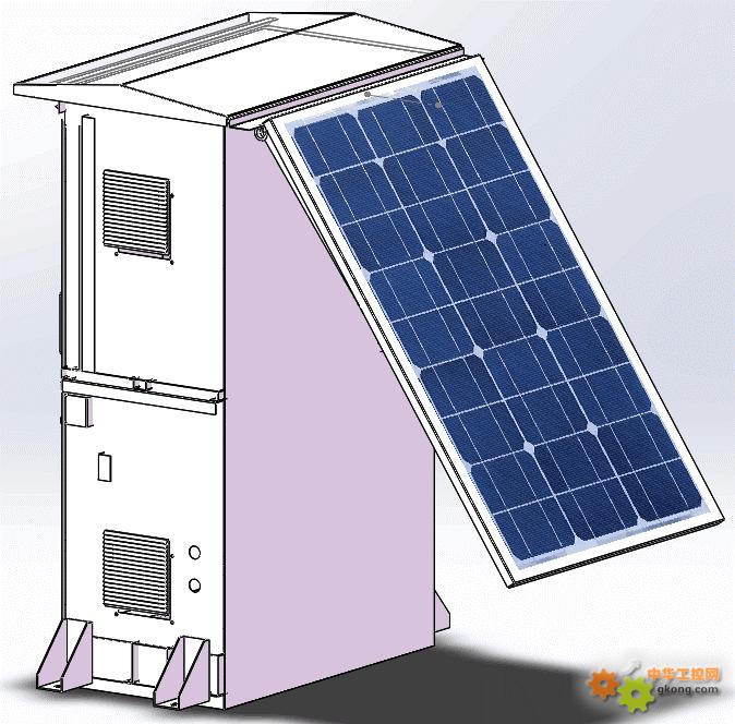

Ì«ÑôÄÜË®Öʼà²âÒDzÉÓÃÒ»ÌåʽÉè¼Æ½á¹¹·½Ê½£¬Ñ¡Ôñ¿Õ¿õµÄλÖ㬵ײ¿ÓõØÁý×öË®Äà¶Õ×Ó¼´¿É°²×°¡£
°²×°Ê¾Òâͼ
