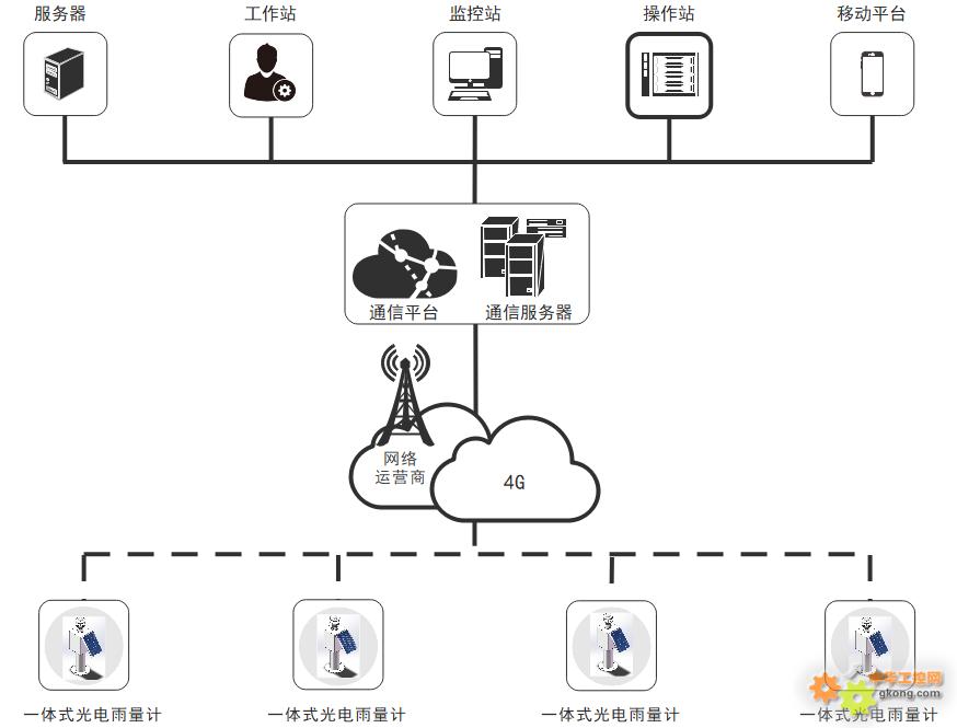

5¡¢Ó¦ÓÃʾÒâͼ

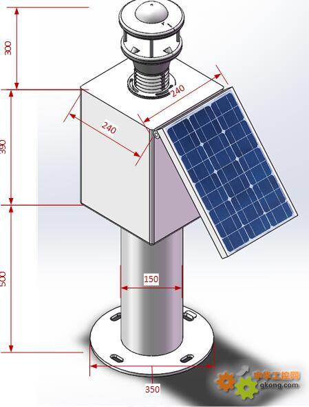

7¡¢ÍâÐγߴç

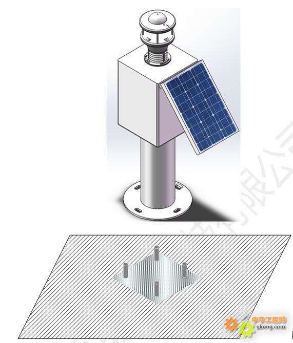

8¡¢°²×°ËµÃ÷
Ò»Ìåʽ¹âµçÓêÁ¿¼Æ²ÉÓÃÒ»ÌåʽÉè¼Æ½á¹¹·½Ê½£¬Ñ¡Ôñ¿Õ¿õµÄλÖ㬵ײ¿ÓõØÁý×öË®Äà¶Õ×Ó¼´¿É°²×°¡£
°²×°Ê¾Òâͼ
