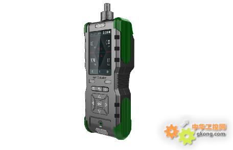

²úÆ·Ãû³Æ£º ±ãЯʽVOCs¼ì²âÒÇ
ÐÍ ºÅ£º XS-2000-VOC
ÊÖ³ÖʽVOC¼ì²âÒÇÖ÷ÒªÓÃÓÚ¼ì²â³µ¼äµÄVOCŨ¶È¡¢³§½çµÄVOCŨ¶È¡¢°²È«Ê¹ÊÓ¦¼±¼à²â¡¢·ÏÆøÅÅ·ÅŨ¶È´ï±ê¿ìËÙ¼ì²â¡£
ÊÖ³ÖʽVOC¼ì²âÒÇ
ÐͺţºXS-2000-VOC
Ò»¡¢²úÆ·ÌØµã
¿ìËÙ¾«È·
²ÉÓýø¿ÚPID¹âÀë×Ó´«¸ÐÆ÷£¬¾«¶È¸ß
ÒÇÆ÷ÄÚº¬¹ýÂË×°Ö㬸ßЧ¹ýÂËÓÍ¡¢Ë®¡¢·Û³¾µÈÔÓÖÊ£¬
¼´Ê¹ÔÚ×îÑÏ¿ÁµÄ¹¤Òµ»·¾³ÖУ¬¼ì²â½á¹ûÒÀÈ»¿ÉÒÔÐÅÀµ
ÈËÐÔ»¯Éè¼Æ£¬Óû§ÒײÙ×÷
3.5´ç¸ßÇå²ÊÆÁ£¬¿ª»ú¼´¿É¼ì²â
´¿Ó²¼þÒ»¼ü¿ª¹Ø»ú, ¼õСµçÁ¿ÏûºÄ
±êÅ䯤ÖÊ¿æ°ü£¬·½±ãЯ´ø
Ñ¡Å䳤ÊÖ±úÎüÆøÌ½¹Ü
ÅܳµÔìÐÍ,ÃÀ¹Û´ó·½
¹¦ÄÜÈ«Ãæ
ͬʱÏÔʾʵÏÖÊý¾ÝºÍŨ¶ÈÇúÏß
ÅäÖøߵÍËٿɵ÷µÄÆø±Ã
×î¶à¿ÉʵÏÖ4ÖÖÆøÌåͬʱ¼ì²â
¿ÉÑ¡ÅäÍâÖÃÀ¶ÑÀ´òÓ¡»ú£¬¼ì²âÊý¾ÝʵÏÖÒÆ¶¯´òÓ¡
Ö§³Ö¶àÖÖÆøÌåÏÔʾµ¥Î»ÈÎÒâÇл»£¬Å¨¶ÈÖµÓÉϵͳ×Ô¶¯»»Ëã
ÖÐÓ¢ÎÄ×ÔÓÉÇл»ÏÔʾ
´óÈÝÁ¿¿ìËÙ´æ´¢¹¦ÄÜ£¬´æ´¢¿Õ¼ä¿ÉÒÔ¶¨ÖÆ
Micro-USB½Ó¿Ú³äµçÆ÷,·½±ãËæÊ±³äµç
°²×¿ÊÖ»úͨÓÃÊý¾ÝÏß,·½±ãÁ¬½ÓµçÄÔ¶ÁÈ¡ÀúÊ·Êý¾Ý
¿ÉÒÔÔÚ¸ßΡ¢¸ßʪ¡¢¸ß·Û³¾»·¾³ÆøÌå¼ì²â£¨ÐèÅä²ÉÑù̽ǹ£©
¶þ¡¢¼¼Êõ²ÎÊý
Ö÷»ú³ß´ç
£¨H x W x D£©233*85*53mm
Ö÷»úÖØÁ¿
Ô¼500¿Ë
²âÁ¿ÆøÌå
»Ó·¢ÐÔÓлúÎVOC£©
´«¸ÐÆ÷¹¤×÷Ô­Àí
¹âÀë×ÓÔ­Àí£¨PID£©£¬Ë«PID´«¸ÐÆ÷ÅäÖÃ
ÆøÌå²âÁ¿·¶Î§
0-10/20/100/200/1000/2000/5000/10000ppm»òÆäËüÁ¿³Ì
·Ö±æÂÊ
1ppb/0.001ppm
ʾֵÎó²î
≤±2%F.S
µ¥Î»Çл»
CFϵÊýºÍÆøÌå·Ö×ÓÁ¿¿ÉÒÔÁé»î×Ô¶¨ÒåÉèÖã¬ÊµÏÖ450¶àÖÖVOCÆøÌåppmºÍmg/m3µ¥Î»Áé»î׼ȷÇл»
±ÃÁ÷Á¿
±ÃËٿɵ÷£¬Á÷Á¿·¶Î§£º0¡«500 cc/min»ò0¡«500mL/min
ÏÔʾÆÁ
3.5´ç²ÊÉ«ÏÔʾÆÁ£¬·Ö±æÂÊ480*320
ÏÔʾÄÚÈÝ
ÆøÌå·Ö×Óʽ£¬²âÁ¿Öµ¡¢¼ÆÁ¿µ¥Î»¡¢Å¨¶ÈʵʱÇúÏß¡¢µç³ØµçÁ¿¡¢Ê±¼ä¡¢·åÖµ¼Ç¼£¬±¨¾¯ÐÅÏ¢£¬¹ÊÕÏÐÅÏ¢µÈ
±¨ ¾¯
·äÃùÆ÷¡¢ºìÉ«±¨¾¯Ö¸Ê¾µÆ¡¢LCDÉϵı¨¾¯×´Ì¬Ìáʾ¡¢µç³ØµÍµçÁ¿±¨¾¯µÈ
¶àµã±ê¶¨
ÌṩÓû§Áãµã¡¢Å¨¶Èµã¡¢Èý¸öÄ¿±êµãµÄ¶àµã±ê¶¨¹¦ÄÜ
Êý¾Ý¼Ç¼
¶ÀÁ¢µÄSD´æ´¢¿¨£º±êÅä8G£¬Ñ¡Åä16G¡¢32GµÈ
²âÁ¿Êý¾Ý×Ô¶¯¼Ç¼¹¦ÄÜ£¬¿É×Ô¶¨Òå¼Ç¼ʱ¼ä¼ä¸ô
ͨѶ¼°Êý¾ÝÏÂÔØ
ÎÞÐèÈí¼þ£¬Ö±½Óͨ¹ýUSBÁ¬½ÓµçÄÔ£¬¿ìËÙÏÂÔØµ¼³öÀúÊ·Êý¾Ý¡¢±¨¾¯Êý¾Ý¼°±ê¶¨Êý¾ÝµÄTXTÎĵµ£»
´òÓ¡¹¦ÄÜ£¨¿ÉÑ¡£©
Á¬½ÓÍâÖÃÀ¶ÑÀ´òÓ¡»ú
´òÓ¡ÄÚÈÝ£¨¿ÉÑ¡£©
ʵʱŨ¶ÈÊý¾Ý,´òÓ¡ÌõÊý¿É×Ô¶¨Òå
³äµçÆ÷
ͨÓÃMicro-USB³äµç½Ó¿Ú£¬5V/2A±ê×¼³äµçÆ÷
µç³Ø
6000 mAH¿É³äµçï®µç³Ø
Óï  ÑÔ
ÖС¢Ó¢ÎÄË«ÓïÇл»
ʪ  ¶È
0¡«95%RH£¨ÎÞÀäÄý), Èôʪ¶È¹ý¸ß¿ÉÑ¡Åä¹ýÂË×°Öà
ÎÂ  ¶È
-20¡æ~ +50¡æ £¨Ñ¡ÅäÑÌÆø²ÉÑù̽ǹ£¬×î¸ß¿É¼ì²â1200¡æµÄÑÌÆøÅ¨¶È£©
·À±¬ÈÏÖ¤
Ex ib IIC T4 Gb
·À»¤µÈ¼¶
IP65
Ö¤Êé
·À±¬ºÏ¸ñÖ¤£¬CEÈÏÖ¤£¬´úËͼìµÚÈý·½¼ÆÁ¿Ôº³öУ׼֤Êé
Ö´Ðбê×¼
GB/T 15322.1-2003¡¢GB/T12358-2006¡¢GB50493-2019
JJF 1172-2007»Ó·¢ÐÔÓлú»¯ºÏÎï¹âÀë×Ó»¯¼ì²âÒÇУ׼¹æ·¶
Q/XSZN 001-2018ºþÄÏϣ˼ÖÇÄܿƼ¼ÓÐÏÞ¹«Ë¾ÆøÌå¼ì²âÒÇÆóÒµ±ê×¼
  • Ó¦Óó¡ºÏ
ʯÓÍ¡¢Ê¯»¯¡¢Ò±½ð¡¢»¯¹¤¡¢Ïû·À¡¢È¼Æø¡¢»·±£¡¢µçÁ¦¡¢Í¨Ñ¶¡¢ÔìÖ½£¬Ó¡È¾¡¢ÎÛË®´¦Àí¡¢Ê³Æ·ÄðÔì¡¢¿ÆÑС¢½ÌÓý¡¢¹ú·À
  • ÒÇÆ÷ÅäÖÃ
