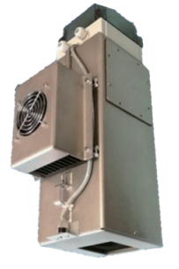

Ö÷Òª²¿¼þ£º
£¨½Ç¶È´«¸ÐÆ÷£©
£¨ºìÍâ±ê¼Ç£©
£¨·ÀÒ¡°Ú¿ØÖÆÆ÷£©
