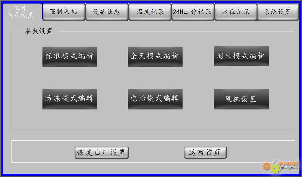

7.2“¹¤×÷ģʽÉèÖÃ”Ò³Ãæ
ͼ7.2 “¹¤×÷ģʽÉèÖÃ”Ò³Ãæ

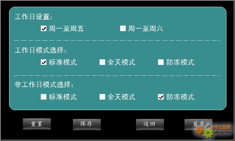

7.2.3ÖÜĩģʽ
ͼ7.5 “ÖÜĩģʽ”Ò³Ãæ
ÔÚÖÜĩģʽÖУ¬¿ÉÉèÖù¤×÷Èպͷǹ¤×÷ÈÕ£»ÔÚ¹¤×÷Èպͷǹ¤×÷ÈÕʱ¾ù¿ÉÉ趨±ê׼ģʽ¡¢È«Ììģʽ»òÕß·À¶³Ä£Ê½ÈýÕ߯äÖÐ֮һΪÆä¹¤×÷ģʽ¡£´ËÖÖģʽ·½±ãÖÜÄ©ÐݼٵĿͻ§Ê¹Óá£

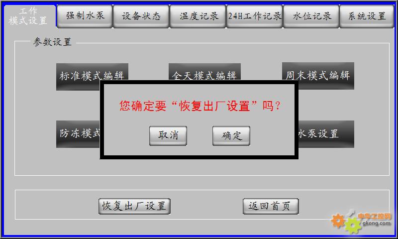

7.2.5»Ö¸´³ö³§ÉèÖÃ
ͼ7.7 “»Ö¸´³ö³§ÉèÖÃ”Ò³Ãæ
µã»÷“»Ö¸´³ö³§ÉèÖÔ°´Å¥¿Éµ¯³öÈ·È϶Ի°¿ò£¬È·ÈϺó¿ÉÒÔ½«ËùÓÐÊý¾Ý»Ö¸´³É³ö³§ÉèÖá£

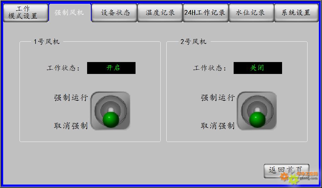

7.3“Ç¿ÖÆ·ç»ú”Ò³Ãæ
ͼ7.8 “Ç¿ÖÆ·ç»ú”Ò³Ãæ
ÔÚ´ËÒ³ÃæÖУ¬ËùÓзç»ú¶¼¿ÉÒÔÇ¿ÖÆ¿ªÆô»òÕ߹رգ¬´Ë¹¦ÄÜÓÃÓڹػú״̬ϵÄϵͳµ÷ÊÔ¡£

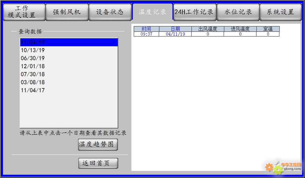

7.5“ζȼǼ”Ò³Ãæ
ͼ7.10 “ζȼǼ”Ò³Ãæ
  1. ϵͳÿ¸ô10·ÖÖÓ×Ô¶¯²É¼¯µ±Ç°µÄ³ö·çζȡ¢½ø·çζȡ¢ÊÒÎÂÊý¾Ý²¢±£´æ£¬ÓÃÓÚÓû§²é¿´ÀúÊ·Êý¾Ý
  2. ϵͳÿÌ콫±£´æµÄ³ö·çζȡ¢½ø·çζȡ¢ÊÒÎÂÊý¾Ý·Ö±ðÉú³ÉÒ»¸öÎļþ´æÓÚϵͳ£¬Ã¿¸öÎļþ±£´æ10Ìì±ã×Ô¶¯É¾³ý¡£ÏµÍ³½«±£´æµÄÎļþ°´ÕÕÈÕÆÚ˳Ðò³ÂÁÐÓÚ×ó²àÁбí¿òÖУ¬Óû§¿É¸ù¾ÝÐèÒªµ÷ÔÄij¸öÈÕÆÚµÄÊý¾Ý£¬µã»÷“ζÈÇ÷ÊÆÍ¼”¿ÉÉú³ÉÏàÓ¦µÄÇúÏßͼ£¬ÒÔ¹©Óû§¸üÐÎÏóµÄ²é¿´Êý¾Ý¶¯Ì¬¡£

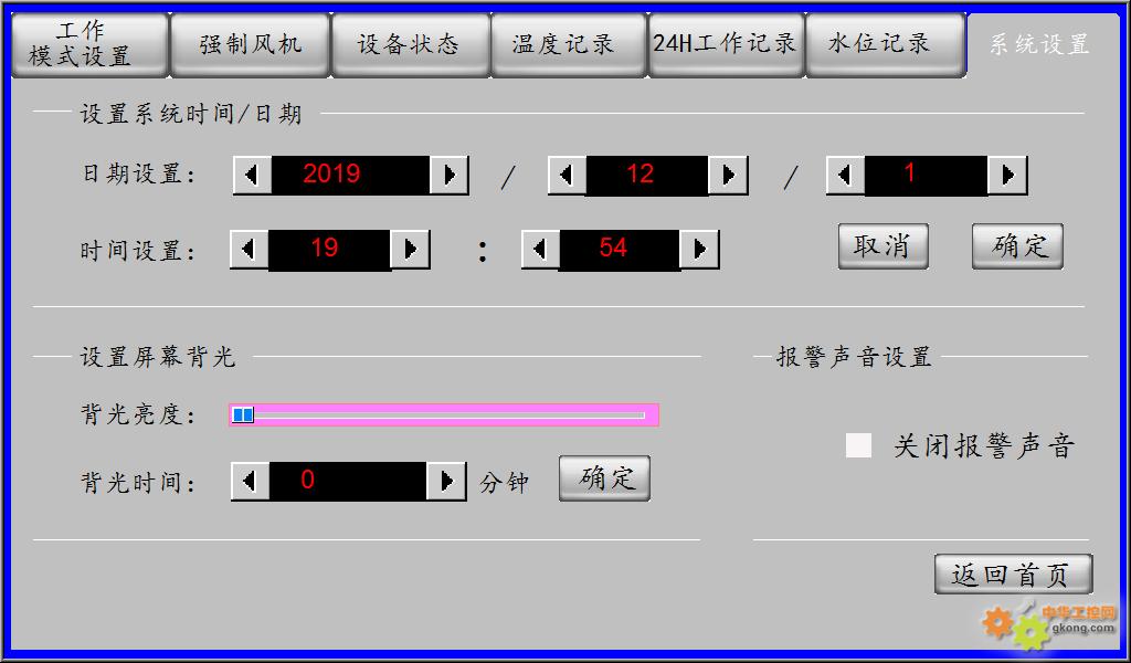

7.7“ϵͳÉèÖÃ”Ò³Ãæ
ͼ7.12 “ϵͳÉèÖÃ”Ò³Ãæ
ÔÚ±¾Ò³ÃæÖУ¬¿ÉÒÔÉèÖÃϵͳʱ¼ä£¬±³¹âµÆÁÁ¶È£¬±³¹âʱ¼ä£¬¹Ø±Õ±¨¾¯ÉùÒô¡£µã»÷“È·¶¨”°´Å¥ÉúЧ¡£
