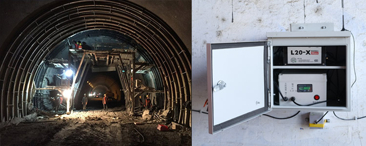

ËíµÀרÓñ¬ÆÆ²âÕñÒÇÏÖ³¡ÔËÓÃ
ÊÊÓÃÓÚ¹«Â·¡¢Ìú·ËíµÀµÄͬһ¼à²â¶ÏÃæ»òͬһ¼à²âÏßÉϵı¬ÆÆÕñ¶¯¼à²â£¬°²×°Ç°£¬Ó¦¸ù¾Ý²âµã²¼ÖÃÇé¿ö¶Ô²âµã¼°Æä´«¸ÐÆ÷½øÐÐͳһ±àºÅ£¬´«¸ÐÆ÷ͨµÀÓë´«¸ÐÆ÷ÐèÒ»Ò»¶ÔÓ¦¡£

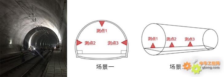

³¡¾°Ò»£ºÍ¬Ò»¼à²â¶ÏÃæ
3¸ö´«¸ÐÆ÷°´ÒªÇó²¼ÖÃÓÚ¶¥¹°ÓëÁ½²à±Ú£¬Í¬Ê±¼à²â3¸ö²âµã
³¡¾°¶þ£ºÍ¬Ò»¼à²âÏß
ÒÔÖмä²âµãΪÖÐÐÄ£¬Ïò×óÓÒÁ½¸ö·½Ïò·Ö±ð²¼ÖÃÁ½¸ö²âµã£¬ÊµÏÖ3¸ö²âµãͬʱ¼à²â

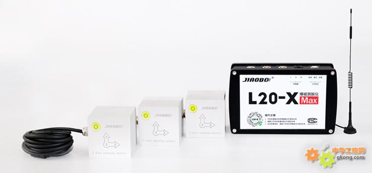

ÐÔÄܲÎÊý
ͨµÀÊýÁ¿£º9ͨµÀ£¬±êÅä3Ö»3ÏòËÙ¶È´«¸ÐÆ÷
²É¼¯·½Ê½£º´¥·¢µçƽ0.001~0.5cm/s£¬¼Ç¼ʱ³¤1~99s
·ùÖµÁ¿³Ì£º±35cm/s
ƵÏ췶Χ£º5-500Hz(±êÅä´«¸ÐÆ÷)
A/D¾«¶È£º24Bit
²ÉÑùƵÂÊ£º5k sps
¸ºÑÓʱ£º0.25s
¹©µç£ºÍâ½Ó8.4V
ͨѶ·½Ê½£ºÁ¬ÐøÍ¨Ñ¶
´æ´¢£º±¾µØ´æ´¢1000Ìõ£¬³¬¹ýºó×Ô¶¯¸²¸Ç
ʱÖÓ£ºÉÏÏßÖ÷¶¯Í¬²½ºÍ¶¨Ê±Í¬²½
Áãµã£ºÆô¶¯²É¼¯Ö÷¶¯Í¬²½£¬¶¨Ê±×Ô¶¯Ð£Áã
ÎïÀí²ÎÊý
³ß´ç£ºÖ÷»ú175*108*57mm£¬´«¸ÐÆ÷:64*64*64mm£¬×ÜÖØÁ¿£º1.95kg
ÏÔʾ£º6¸ö¶à¹¦ÄÜָʾµÆ
°´¼ü£ºÆô¶¯ / Í£Ö¹°´Å¥£¨¸´Î»°´Å¥£©
½Ó¿Ú£º1¸ö4GÌìÏß½Ó¿Ú£¬1¸öLAN½Ó¿Ú£¬1¸öDC½Ó¿Ú£¬3¸ö´«¸ÐÆ÷½Ó¿Ú
ʹÓû·¾³£º-30-60 ¡æ£¬90 £¥ R
Öʱ££ºÈýÄê
