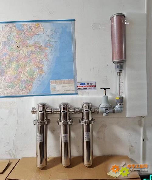

1. É豸˵Ã÷
£¨1£©±¾¹«Ë¾Éú²úµÄѹËõ¿ÕÆø¹ýÂËÆ÷£¬ÂËоÄÚ²¿²ÉÓÃÊÀ½çÃûÅÆµÂ¹úHV¹«Ë¾µÄ½ø¿ÚÂ˲쬰´¹ýÂ˾«¶ÈµÄ²»Í¬ÓÐTϵÁÐ AϵÁÐHϵÁеÈ3¸öµÈ¼¶¡£
£¨2£©Ñ¹Ëõ¿ÕÆø½øÈë¹ýÂËÆ÷ÄÚ£¬Í¨¹ýÀ¹½Ø¡¢¹ßÐÔ¡¢À©É¢¡¢ÖØÁ¦µÈ×÷Óã¬ÓÐЧµØÈ¥³ýѹËõ¿ÕÆøÖк¬ÓеÄË®·Ý¡¢³¾Á£¡¢ÓÍÎíµÈÔÓÖÊ£¬´Ó¶øÊ¹Ñ¹Ëõ¿ÕÆø½à¾»¸ÉÔï£¬Ê¹Æø¶¯É豸¿É¿¿ÐÔÌá¸ß£¬²úÆ·ÖÊÁ¿ÌáÉý¡£º¼Öݼѽ๫˾µÄÂËо±¾ÉíÓöà²ã´ÎµÄÂË´²¹¹Ô죬ÆäÈݳ¾Á¿¼«´ó£¬ÓÐЧÐԸߣ¬Ê¹ÓÃÊÙÃü³¤£¬ÊǹúÄÚѹËõ¿ÕÆø¾»»¯É豸ÁìÓòÒ»Ö¹«Èϵġ£±¾¹«Ë¾Éè¼ÆµÄ¹ýÂËÆ÷£¬½á¹¹¼òµ¥£¬²ð×°ÂËо·½±ã£¬Ê¹ÓÃÐÔÄܱ£Ö¤¡£

3. É豸Çåµ¥
£¨1£©Èý¼¶¹ýÂËÆ÷£º1Ì×
£¨TϵÁР AϵÁР HϵÁУ©
£¨2£©µ÷ѹ·§£º1Ö»
£¨3£©ÏûÒôÆ÷£º1Ö»
£¨4£©Á÷Á¿¼Æ£º1Ö»
£¨¿ÉÑ¡Å䣬Âú×ãÿÈËÿ·ÖÖÓ0.3m3µÄÁ÷Á¿Á¿³ÌÒªÇó£©
£¨5£©¹Ü½Ó¼þ£º1Ì×

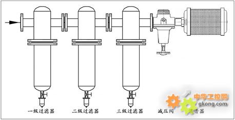

¶þ   °²×°ÓëÅäÖÃ
1.  °²×°Ê±£¬±ØÐë°´ÕÕ¹ýÂËÆ÷ÉÏµÄ¿ÕÆø½ø³ö¿Ú±êÇ©Á¬½ÓºÃ¹ÜµÀ¡£·ñÔò½«½ø³ö¿Ú·´×°»áÑÏÖØÓ°Ïì¹ýÂËЧ¹û¡£ÎªÁ˱ãÓÚʹÓú͸ü»»Î¬ÐÞ,¹ýÂËÆ÷Ó¦°´ÏÂͼËùʾµÄ±ê×¼¹ÜÏß½øÐа²×°¡£
2.  ±ÜÄÑíÏÊÒѹ·ç¹ýÂËÆ÷µÄÅäÖÿɲο¼ÏÂͼËùʾµÄÐÍʽ½øÐС£
