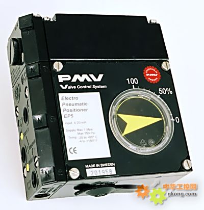

产品名称: Flowserve EP5系列电气定位器
型  号: EP5系列电气定位器
EP5 电动气动定位器由 PMV P5 气动定位器改造而成。 这个紧凑而坚固的单元旨在最大程度地提高其在各类环境中的性能。 EP5 有标准、真正安全和防爆三个版本。
Flowserve EP5系列电气定位器技术参数:
输入信号Input signal
4–20 mA
线性度Linearity
< 1%
迟滞Hysteresis
< 0.75%
重复精度Repeatability
< 0.5%
死区Deadband
< 0.15%
气体供给Air supply
Max. 1 MPa/150 Psi, Oil, water and dustfree Min. 0.14
MPa/21 Psi
连接螺纹Connector threads
1/4" NPT or G (BSP)
压力表螺纹Gauge threads
1/8" NPT or G (BSP)
电气接口Counduit entry
1/2" NPT or M20
接线端Terminals
2.5 mm2 (AWG 14) Screw terminals
Flowserve EP5系列电气定位器选型表:
型号Model
EP5XX
EP5 Double acting pneumatic
EP5FS
Fail freeze function
EP5IS
Intrinsically safe, ATEX, FM, CSA
EP5EU
Explosion proof ATEX
EP5US
Explosion proof CSA, FM
滑阀Spool valve
HP
High performance
LB
Normal Gain
接口Connections
N
1/4"NPT , El. 1/2" NPT
G
1/4"G  air, M20 x 1,5 electric
M
1/4"NPT1/4  air, M20 x 1,5 electric
表面处理Surface treatment
U
Epoxy coating
M
Tufram
转轴Spindle
01, 23 etc
01 to 39. See dwg SPNDLS_P5
凸轮Cam
K01, K08 etc
K01 to K34
上端盖Front cover
PV9DA
 90°, Direct, arrow indicator
输入信号Input signal
4
4–20 input
温度Temperature
N
Nitrile seals –20°C to +85°C
Q
Silicon seals, –40°C to +85°C
举例Example:EP5XX-HPNU-23K01-PV9DA-4Z
