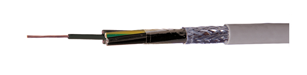

CY Control Cable to BS6500
CY Cable is a flexible multi-core cable with class 5 flexible plain copper conductors, PVC insulation, a PETP (Polyethylene Terephthalate) separator, a tinned copper wire braid and a grey PVC sheath. The construction of a LS0H CY Control Cable differs slightly – XLPE (Cross-Linked Polyethylene) insulation and a LS0H sheath are used in place of the PVC layers. CY Cable is also known as Instrumentation Cable, CY Flex, CY Control Flex, Robotic Cable, Copper Screened Control Cable, Shield Control Cable, Motor Cable, Multi-core Cable and Screened Cable.
