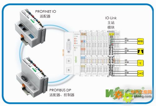

WAGO-I/O-SYSTEM的新型PROFINET适配器带有内置交换机,用户在应用开放式自动化工业以太网标准时就会更加容易。可通过内置交换机进行线形布线或外置交换机进行星型布线,并且具有自动协商、自动交叉和全双工的性能。利用PROFINET,可以在工业以太网上将现场设备灵活和完美集成。
WAGO-I/O-SYSTEM new PROFINET coupler with built-in switch, the user in the application of an open Ethernet standard automation industry will be much easier. Topology line through the built-in switch or topology star through external switch, and this coupler has performance of auto-negotiation, auto-cross and full-duplex. Using PROFINET, Industrial Ethernet can be flexible and will be the perfect integration of field devices.
随着日益复杂的产品、生产的灵活化以及对于质量保障的高要求,均需要采用智能化、可设置参数的传感器。其中用于连接控制系统和加工系统的必需的多种不同接口,现在都通过IO-Link实现了标准化。可通过3线接点将过程数据以及非循环数据传递给相应设备(传感器和执行器)。主站模块和设备的描述文件对其功能和性能参数进行了详细说明,还可通过WAGO-IO-Check软件对参数进行调整。出于需要更换设备后,所有配置参数都可自动重新生成,无需维护人员再次设置。因此,规划、安装和运行均得到了明显简化!
Increasingly complex products, manufacturing flexibility and high demands on quality assurance require intelligent, configurable and programmable sensors. IO-Link now elegantly standardizes the required, varying interfaces for connecting to a control system and tooling. A 3-wire connection can communicate process data, as well as acyclic data to both sensors and actuators. The functions and performance data are defined in device description files for master and devices; these are easy to customize via WAGO-I/O-CHECK. If a device has to be replaced, the configuration and parameterization can be automatically restored without the intervention of maintenance personnel. Project design, installation and operation are thus simplified significantly.
