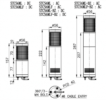

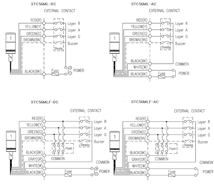

DC ³¤ÁÁÐͲúÆ·
  • Òý³ö µçÔ´Ïߣ¬ÐźÅÏß ¹æ¸ñ : UL1007-NO.22(0.3sq) 400mm
  • ºÚÉ« ¹²ÓÃÏß±íʾ¸º¼«(-)£¬µ«²úÆ·ÄÚ²¿ÓÐÕûÁ÷ÇÅ£¬²úÆ·²»Ó÷ÖÕý¸º¼«¡£
AC³¤ÁÁÐÍ, AC/DC ³¤ÁÁ/ÉÁÁÁÐͲúÆ·
  • Òý³ö µçÔ´Ïß ¹æ¸ñ : UL1015-NO.18(0.75sq) x 2c 400mm
    AC µçѹ²úÆ·£º²»Ó÷ֵçÔ´ÏßÑÕÉ«£¬¿ÉÒÔ½»Ìæ½ÓÏß¡£
    DC µçѹ²úÆ·£ººÚÉ«ÏßÁ¬½ÓÔÚ¸º¼«(-)¡£
  • Òý³ö ÐźÅÏß ¹æ¸ñ : UL1007-NO.22 (0.3sq) 400mm
EX)STC56ML -(BZ) -3 -220 -RAG
