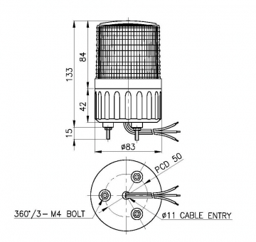

²úÆ·Ãû³Æ£º ¶àÉ« LED ³¤ÁÁ/ÉÁÁÁ ¾¯Ê¾µÆ SMCL80
ÐÍ ºÅ£º SMCL80
Æ· ÅÆ£º 587
ÓÃÒ»¸ö¾¯Ê¾µÆ¿ÉÒÔ´«´ï2-3¸öÑÕÉ«ÐźÅ
  • ÓÃÒ»¸ö¾¯Ê¾µÆ´«´ï2-3¸öÑÕÉ«Ðźŵľ­¼ÃÐÍ
  • ÀûÓÃÌØÊâ·´Éä¾µ¾Û¼¯LED¹âÏߣ¬·¢³öÓëÀàËÆÓÚµÆÅݵÆË¿µÄ¹âÏߣ¬Ìá¸ßÔ¶¾àÀë¿É¼û¶È
  • ʹÓÃÌØÊâµÆÕÖ, ¸ÄÉÆLED²úÆ·¿É¼û¶ÈϽµµÄȱµã
  • ±ê×¼ÑÕÉ«( ºì-R »Æ-A£¬ »Æ-A ÂÌ-G ÑÕÉ«¿ÉÒÔ¶¨×ö)
    2É« :  ºì-R  ÂÌ-G
    3É« :  ºì-R  »Æ-A  ÂÌ-G
  • ÉÁÁÁ´ÎÊý : 60~80/min.
  • ÄÚ×°·äÃùÆ÷ÐÍ ÒôÁ¿ : Max.90dB/m (¿ÉÒÔ¶¨×ö2Òô·äÃùÆ÷ÐÍ)
  • ²ÄÖÊ : µÆÕÖ-AS, µ××ù-ABS, ·´Éä¾µ-ÄÍÈÈÐÔ ABS
  • ¼¼ÊõÈÏÖ¤ : CE
  • ±£»¤µÈ¼¶ : IP44
Ðͺеçѹ µçÁ÷ ÖØÁ¿ ÑÕÉ«(2É«,3É«)
                      SMCL80            DC12V            0.300A            0.21Kg            ºì-R
           ÂÌ-G
           DC24V            0.260A            0.21Kg

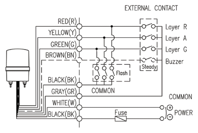

  • Òý³ö µçÔ´Ïß ¹æ¸ñ : UL1015-NO.18(0.75sq) x 2c 400mm
    AC ²úÆ· £º²»Ó÷ֵçÔ´ÏßÑÕÉ«£¬¿ÉÒÔ½»Ìæ½ÓÏß¡£
    DC ²úÆ·£ººÚÉ«Ïß±íʾ¸º¼«(-)£¬µ«²úÆ·ÄÚ²¿ÓÐÕûÁ÷ÇÅ£¬²úÆ·²»Ó÷ÖÕý¸º¼«¡£
  • Òý³ö¡¡ÐźÅÏß¡¡¹æ¸ñ : UL1007-NO.22 (0.3sq) 400mm
결선도
EX)SMCL80 -(BZ) -3 -220 -RAG
ÐͺŠ·äÃùÆ÷ ÑÕÉ«Êý µçѹ ÑÕÉ«
          SMCL80           ÎÞÖ¸¶¨(None)
          ±ê×¼ÐÍ
          BZÖ¸¶¨(Order)
          ÄÚ×°·äÃùÆ÷ÐÍ
               2-2É«
               3-3É«
          12-DC12V
          24-DC24V
          110-AC110V
          220-AC220V
               R-ºì
               A-»Æ
               G-ÂÌ
