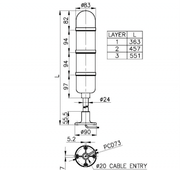

  • תËÙ : 120~140 RPM
  • ´øPole(¹Ü×Ó)ºÍ°²×°Ö§¼ÜÐÍ£¬°²×°¼ò±ã
  • ±£»¤µÈ¼¶ : IP44
ÐͺжÎÊý µçѹ µçÁ÷ µÆÅÝ ÖØÁ¿ ÑÕÉ«
               SRP      1
    DC12V
     0.540A      12V5W      T16x35 15S  5       0.32Kg      ºì-R
    DC24V
     0.310A      24V5W      T16x35 15S  6       0.32Kg
    AC110V
     0.100A      12V5W      T16x35 15S  5       0.38Kg
    AC220V
     0.050A      12V5W      T16x35 15S  5       0.38Kg
     2
    DC12V
     1.100A      12V5W      T16x35 15S  5       0.67Kg      ºì-R
     ÂÌ-G
    DC24V
     0.640A      24V5W      T16x35 15S  6       0.67Kg
    AC110V
     0.170A      12V5W      T16x35 15S  5       0.85Kg
    AC220V
     0.070A      12V5W      T16x35 15S  5       0.85Kg
     3
    DC12V
     1.620A      12V5W      T16x35 15S  5       0.82Kg      ºì-R
     »Æ-A
     ÂÌ-G
    DC24V
     0.940A      24V5W      T16x35 15S  6       0.82Kg
    AC110V
     0.220A      12V5W      T16x35 15S  5       1.26Kg
    AC220V
     0.100A      12V5W      T16x35 15S  5       1.26Kg

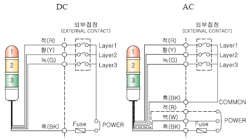

  • AC µçѹ²úÆ·
    µçÔ´Ïß ¹æ¸ñ :  UL1015-NO.18 (0.75sq) x 2C 400mm
    ÐźÅÏß ¹æ¸ñ :  UL1007-NO.22 (0.3sq) 400mm
  • AC110VºÍ AC220V ¹²Óõ͍×ö²úÆ·
    ʹÓÃAC110VʱµÄµçÔ´Ïß : ºÚÉ«-°×É« ½ÓÏß
    ʹÓÃAC220VʱµÄµçÔ´Ïß : ºÚÉ«-ºìÉ« ½ÓÏß
  • DC µçѹ²úÆ·
    µçÔ´ÏߺÍÐźÅÏß ¹æ¸ñ :  UL1007-NO.22 (0.3sq)  400mm
    ºÚÉ«ÏßÁ¬½ÓÔÚ¸º¼«(-)
EX)SRP -3 -24 -RAG
