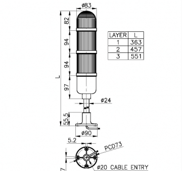

ÓÃÒ»¸ö°²×°¿Õ¼ä´«´ï¶àÖÖÐźŵĶà²ãʽLED¾¯Ê¾µÆ
  • ¸ßÁÁ¶È LED ³¤ÁÁ/ÉÁÁÁÐÍ ¶à²ãʽ¾¯Ê¾µÆ
  • ¸÷²ã¿ÉÒÔµ¥¶ÀÑ¡Ôñ³¤ÁÁ/ÉÁÁÁ
  • ²ÉÓÃÊÙÃüΪ°ëÓÀ¾ÃÐÔµÄLED¹âÔ´£¬ÊʺÏÓÃÓÚÕ𶯻ò³å»÷½Ï´óµÄÉ豸
  • ͬʱ²¶×½¶àÖÖÐźţ¬Ò²ÄÜ´«´ïµ¥¸öÐźÅ
  • ÀûÓñ¾Ë¾¿ª·¢µÄÖ±±³¹âϵͳ£¬ÐźŹâÏߵķ¢É¢Ð§¹ûÌØ±ðÓÅÐã
  • ±ê×¼ÑÕÉ« (±ê×¼ÑÕÉ«ÒÔÍâÑÕÉ«ÅÅÁпÉÓÉʹÓÃÕßÀ´Ö¸¶¨)
    1²ã : ºì-R
    2²ã : ºì-R ÂÌ-G
    3²ã : ºì-R »Æ-A ÂÌ-G
  • ÉÁÁÁ´ÎÊý(ÉÁÁÁÐÍ): 60~80/min.
  • ²ÄÖÊ : µÆÕÖ-AS, µ××ù-ABS, ·´Éä¾µ-ÄÍÈÈÐÔ ABS
  • ´ø¹Ü×ӺͰ²×°Ö§¼ÜÐÍ£¬°²×°¼ò±ã
  • ±£»¤µÈ¼¶ : IP44
ÐͺжÎÊý µçѹ µçÁ÷ ÖØÁ¿ ÉÁÁÁ´ÎÊý ÑÕÉ«
                 SRLP       1
      DC12V
        0.090A         0.25Kg      60~80/min.         ºì-R
      DC24V
        0.080A         0.25Kg
      AC110V
        0.044A         0.64Kg
      AC220V
        0.022A         0.64Kg
      2
      DC12V
        0.180A         0.38Kg         ºì-R
        ÂÌ-G
      DC24V
        0.160A         0.38Kg
      AC110V
        0.052A         0.81Kg
      AC220V
        0.026A         0.81Kg
      3
      DC12V
        0.270A         0.54Kg         ºì-R
        »Æ-A
        ÂÌ-G
      DC24V
        0.240A         0.54Kg
      AC110V
        0.060A         0.98Kg
      AC220V
        0.030A         0.98Kg
  • AC µçѹ²úÆ·
    µçÔ´Ïß ¹æ¸ñ :  UL1015-NO.18 (0.75sq) x 2C 400mm
    ÐźÅÏß ¹æ¸ñ :  UL1007-NO.22 (0.3sq) 400mm
  • DC µçѹ²úÆ·
    Òý³ö µçÔ´ÏߺÍÐźÅÏß ¹æ¸ñ : UL1007-NO.22(0.3sq)
    ºÚÏß¹²ÓÃÏß±íʾ¸º¼«(-)£¬µ«²úÆ·ÄÚ²¿ÓÐÕûÁ÷ÇÅ£¬²úÆ·²»Ó÷ÖÕý¸º¼«¡£
  • AC110VºÍ AC220V ¹²Óõ͍×ö²úÆ·
    ʹÓÃAC110VʱµÄµçÔ´Ïß : ºÚÉ«-°×É« ½ÓÏß
    ʹÓÃAC220VʱµÄµçÔ´Ïß : ºÚÉ«-ºìÉ« ½ÓÏß
EX)SRLP -3 -24 -RAG
ÐͺжÎÊý µçѹ ÑÕÉ«
                   SRLP                     1-1²ã
                    2-2²ã
                    3-3²ã
                 12-DC12V
                 24-DC24V
                 110-AC110V
                 220-AC220V
                  R-ºì
                  A-»Æ
                  G-ÂÌ
