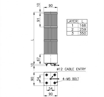

¹âÔ´ÊÙÃüΪ°ëÓÀ¾ÃµÄ·½ÐÎLED¶à²ãʽ¾¯Ê¾µÆ
  • ÍâÐÎÃÀ¹ÛµÄ·½ÐθßÁÁ¶ÈLED³¤ÁÁ/ÉÁÁÁÐͶà²ãʽ¾¯Ê¾µÆ
  • ¸÷²ã¿ÉÒÔµ¥¶ÀÑ¡Ôñ³¤ÁÁ/ÉÁÁÁ
  • ²ÉÓÃÊÙÃüΪ°ëÓÀ¾ÃÐÔµÄLED¹âÔ´£¬ÊʺÏÓÃÓÚÕ𶯻ò³å»÷½Ï´óµÄÉ豸
  • ͬʱ²¶×½¶àÖÖÐźţ¬Ò²ÄÜ´«´ïµ¥¸öÐźÅ
  • ÀûÓñ¾Ë¾¿ª·¢µÄÖ±±³¹âϵͳ£¬ÐźŹâÏߵķ¢É¢Ð§¹ûÌØ±ðÓÅÐã
  • ÒôÁ¿(ÄÚ×°·äÃùÆ÷ÐÍ) : Max.90dB/m (¿ÉÒÔ¶¨×ö2Òô·äÃùÆ÷ÐÍ)
  • ±ê×¼ÑÕÉ« (±ê×¼ÑÕÉ«ÒÔÍâÑÕÉ«ÅÅÁпÉÓÉʹÓÃÕßÀ´Ö¸¶¨)
    1²ã : ºì-R
    2²ã : ºì-R ÂÌ-G
    3²ã : ºì-R »Æ-A ÂÌ-G
  • ÉÁÁÁ´ÎÊý(ÉÁÁÁÐÍ): 60~80/min.
  • ²ÄÖÊ : µÆÕÖ-AS, µ××ù-ABS, ·´Éä¾µ-ÄÍÈÈÐÔ ABS
  • ±£»¤µÈ¼¶ : IP44
ÐͺжÎÊý µçѹ µçÁ÷ ÖØÁ¿ ÉÁÁÁ´ÎÊý ÑÕÉ«
                  SJL       1
      DC12V
        0.140A         0.51Kg      60~80/min.         ºì-R
      DC24V
        0.120A         0.51Kg
      AC110V
        0.048A         0.93Kg
      AC220V
        0.024A         0.93Kg
      2
      DC12V
        0.280A         0.74Kg         ºì-R
        ÂÌ-G
      DC24V
        0.240A         0.74Kg
      AC110V
        0.056A         0.74Kg
      AC220V
        0.028A         1.13Kg
      3
      DC12V
        0.420A         1.13Kg         ºì-R
        »Æ-A
        ÂÌ-G
      DC24V
        0.360A         1.09Kg
      AC110V
        0.064A         1.33Kg
      AC220V
        0.032A         1.33Kg

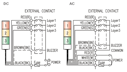

  • AC µçѹ²úÆ·
    µçÔ´Ïß ¹æ¸ñ :  UL1015-NO.18 (0.75sq) x 2C 400mm
    ÐźÅÏß ¹æ¸ñ :  UL1007-NO.22 (0.3sq) 400mm
  • DC µçѹ²úÆ·
    Òý³ö µçÔ´ÏߺÍÐźÅÏß ¹æ¸ñ : UL1007-NO.22(0.3sq)
    ºÚÏß¹²ÓÃÏß±íʾ¸º¼«(-)£¬µ«²úÆ·ÄÚ²¿ÓÐÕûÁ÷ÇÅ£¬²úÆ·²»Ó÷ÖÕý¸º¼«¡£
  • AC110VºÍ AC220V ¹²Óõ͍×ö²úÆ·
    ʹÓÃAC110VʱµÄµçÔ´Ïß : ºÚÉ«-°×É« ½ÓÏß
    ʹÓÃAC220VʱµÄµçÔ´Ïß : ºÚÉ«-ºìÉ« ½ÓÏß
EX)SJL -3 -(BZ) -220 -RAG
ÐͺжÎÊý ·äÃùÆ÷ µçѹ ÑÕÉ«
               SJL                1-1²ã
               2-2²ã
               3-3²ã
           ÎÞÖ¸¶¨(None)
           ±ê×¼ÐÍ
           BZÖ¸¶¨(Order)
           ÄÚ×°·äÃùÆ÷ÐÍ
           12-DC12V
           24-DC24V
           110-AC110V
           220-AC220V
               R-ºì
              A-»Æ
              G-ÂÌ
