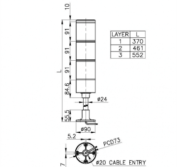

Ìá¸ß×Ô¶¯»¯É豸Ʒ¸ñµÄÍâÐÎÃÀ¹ÛµÄ²úÆ·£¬ÓÃÒ»¸ö°²×°¿Õ¼ä´«´ï¶àÖÖÐźÅ
  • ÍâÐÎÃÀ¹ÛµÄ·½ÐεÆÅÝ·´Éä¾µÐýתÐͶà²ãʽ¾¯Ê¾µÆ
  • ²ÉÓÃÔëÒôºÍÄ¥Ëð¼«Ð¡µÄ¶¯Á¦´«´ï×°ÖÃ
  • ÒôÁ¿(ÄÚ×°·äÃùÆ÷ÐÍ) : Max.90dB/m (¿ÉÒÔ¶¨×ö2Òô·äÃùÆ÷ÐÍ)
  • ±ê×¼ÑÕÉ« (±ê×¼ÑÕÉ«ÒÔÍâÑÕÉ«ÅÅÁпÉÓÉʹÓÃÕßÀ´Ö¸¶¨)
    1²ã : ºì-R
    2²ã : ºì-R ÂÌ-G
    3²ã : ºì-R »Æ-A ÂÌ-G
  • תËÙ :120~140 RPM
  • ´ø¹Ü×ӺͰ²×°Ö§¼ÜÐÍ£¬°²×°¼ò±ã
  • ²ÄÖÊ : µÆÕÖ-AS, µ××ù-ABS, ·´Éä¾µ-ÄÍÈÈÐÔ ABS
  • ¼¼ÊõÈÏÖ¤ : CE
  • ±£»¤µÈ¼¶ : IP44

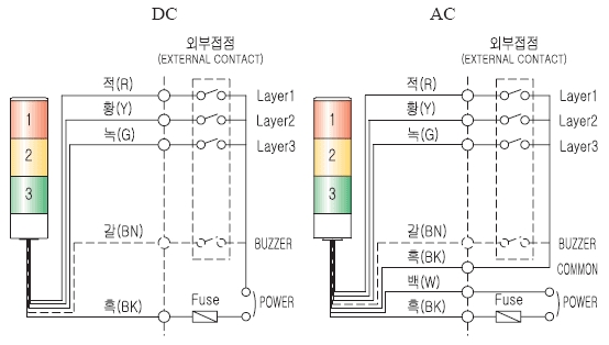

  • AC µçѹ²úÆ·
    µçÔ´Ïß ¹æ¸ñ :  UL1015-NO.18 (0.75sq) x 2C 400mm
    ÐźÅÏß ¹æ¸ñ :  UL1007-NO.22 (0.3sq) 400mm
  • AC110VºÍ AC220V ¹²Óõ͍×ö²úÆ·
    ʹÓÃAC110VʱµÄµçÔ´Ïß : ºÚÉ«-°×É« ½ÓÏß
    ʹÓÃAC220VʱµÄµçÔ´Ïß : ºÚÉ«-ºìÉ« ½ÓÏß
  • DC µçѹ²úÆ·
    µçÔ´ÏߺÍÐźÅÏß ¹æ¸ñ :  UL1007-NO.22 (0.3sq)  400mm
    ºÚÉ«ÏßÁ¬½ÓÔÚ¸º¼«(-)
EX)SJP -3 -(BZ) -24 -RAG
