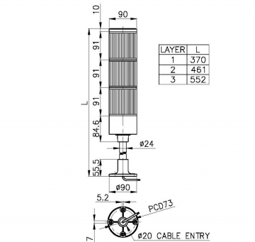

¸ßÁÁ¶È ±¬ÉÁÐÍ ¾¯Ê¾µÆ£¬Ô¶¾àÀë¿É¼û¶ÈºÍÄ;ÃÁ¦ÌرðÓÅÐã
  • ë¯µÆ¹Ü ±¬ÉÁÐÍ ¾¯Ê¾µÆ
  • Ç¿ÁÒµÄÐźÅÉÁ¹â£¬Ô¶¾àÀë´«´ïÐźÅЧ¹ûºÃ
  • µÆ¹Ü²ÉÓýӲåʽ½á¹¹£¬¸ü»»ë¯µÆ¹Ü·½±ã
  • ͬʱ²¶×½¶àÖÖÐźţ¬Ò²ÄÜ´«´ïµ¥¸öÐźÅ
  • ÒôÁ¿(ÄÚ×°·äÃùÆ÷ÐÍ) : Max.90dB/m (¿ÉÒÔ¶¨×ö2Òô·äÃùÆ÷ÐÍ)
  • ±ê×¼ÑÕÉ« (±ê×¼ÑÕÉ«ÒÔÍâÑÕÉ«ÅÅÁпÉÓÉʹÓÃÕßÀ´Ö¸¶¨)
    1²ã : ºì-R
    2²ã : ºì-R ÂÌ-G
    3²ã : ºì-R »Æ-A ÂÌ-G
  • ÉÁÁÁ´ÎÊý : 60~80/min.
  • ´ø¹Ü×ӺͰ²×°Ö§¼ÜÐÍ£¬°²×°¼ò±ã
  • ²ÄÖÊ : µÆÕÖ-AS, µ××ù-ABS
  • ±£»¤µÈ¼¶ : IP44
ÐͺжÎÊý µçѹ µçÁ÷ ÖØÁ¿ µÆÅÝ ÉÁÁÁ´ÎÊý ÑÕÉ«
                 SJSP      1
    DC12V
      0.195A       0.54Kg           47     60~80/min.       ºì-R
    DC24V
      0.173A       0.54Kg
    AC110V
      0.025A       0.53Kg
    AC220V
      0.022A       0.53Kg
     2
    DC12V
      0.385A       0.67Kg       ºì-R
      ÂÌ-G
    DC24V
      0.340A       0.67Kg
    AC110V
      0.048A       0.66Kg
    AC220V
      0.041A       0.66Kg
      3
    DC12V
      0.570A       0.89Kg       ºì-R
      »Æ-A
      ÂÌ-G
    DC24V
      0.510A       0.89Kg
    AC110V
      0.069A       0.88Kg
    AC220V
      0.063A       0.88Kg

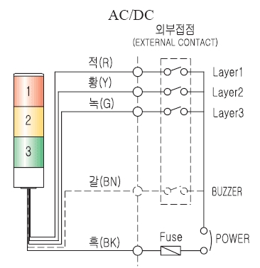

  • Òý³ö µçÔ´ÏߺÍÐźÅÏß ¹æ¸ñ :  UL1007-NO.22 (0.3sq) 400mm
  • DC µçѹ²úÆ·
    ºÚÏß¹²ÓÃÏß±íʾ¸º¼«(-)£¬µ«²úÆ·ÄÚ²¿ÓÐÕûÁ÷ÇÅ£¬²úÆ·²»Ó÷ÖÕý¸º¼«¡£
EX)SJSP -3 -(BZ) -220 -RAG
ÐͺжÎÊý ·äÃùÆ÷ µçѹ ÑÕÉ«
              SJSP                1-1²ã
               2-2²ã
               3-3²ã
           ÎÞÖ¸¶¨(None)
           ±ê×¼ÐÍ
           BZÖ¸¶¨(Order)
           ÄÚ×°·äÃùÆ÷ÐÍ
           12-DC12V
           24-DC24V
           110-AC110V
           220-AC220V
               R-ºì
              A-»Æ
              G-ÂÌ
