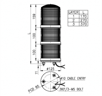

²úÆ·Ãû³Æ£º LED ³¤ÁÁ/ÉÁÁÁÐÍ ¶à²ãʽ¾¯Ê¾µÆS125TL
ÐÍ ºÅ£º S125TL
Æ· ÅÆ£º 587
·¢É¢Ç¿ÁÒµÄÐźŹâÏߵĴóÐͶà²ãʽ¾¯Ê¾µÆ
  • ²ÉÓøßÁÁ¶ÈLEDΪ¹âÔ´£¬ÄÚ×°³¤ÁÁ/ÉÁÁÁÑ¡Ôñ¿ª¹Ø
  • ²ÉÓÃÊÙÃüΪ°ëÓÀ¾ÃÐÔµÄLED¹âÔ´£¬ÊʺÏÓÃÓÚÕñ¶¯»ò³å»÷½Ï´óµÄÉ豸
  • É¢¹âÃæ»ý½Ï´óµÄ´óÐͶà²ãÐźŵƣ¬ÔÚÔ¶¾àÀë»òÕ߻ҳ¾½Ï¶àµÄ»·¾³Ï¿ɼû¶È·Ç³£ÓÅÐã
  • ±ê×¼ÑÕÉ« (±ê×¼ÑÕÉ«ÒÔÍâÑÕÉ«ÅÅÁпÉÓÉʹÓÃÕßÀ´Ö¸¶¨)
    1²ã : ºì-R
    2²ã : ºì-R ÂÌ-G
    3²ã : ºì-R »Æ-A ÂÌ-G
  • ÉÁÁÁ´ÎÊý : 60~80/min.
  • ²ÄÖÊ : µÆÕÖ-AS, µ××ù-ABS, ·´Éä¾µ-ÄÍÈÈÐÔ ABS
  • ±£»¤µÈ¼¶ : IP44

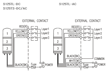

  • AC µçѹ²úÆ·
    µçÔ´Ïß ¹æ¸ñ : UL1015-NO.18 (0.75sq) x 2C 400mm
    ÐźÅÏß ¹æ¸ñ : UL1007-NO.22 (0.3sq) x 2C 400mm
  • DC µçѹ²úÆ·
    µçÔ´ÏߺÍÐźÅÏß ¹æ¸ñ : UL1007-NO.22 (0.3sq) x2C 400mm
    ºÚÉ«¹²ÓÃÏß±íʾ¸º¼«(-)£¬µ«²úÆ·ÄÚ²¿ÓÐÕûÁ÷ÇÅ£¬²úÆ·²»Ó÷ÖÕý¸º¼«¡£
