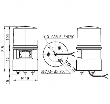

²úÆ·Ãû³Æ£º Éù¹â×éºÏ µÆÅÝ ·´Éä¾µÐýת ¾¯Ê¾µÆS125D
ÐÍ ºÅ£º S125D
Æ· ÅÆ£º 587
ÊʺÏÓÃÓÚ»ú´²¡¢×Ô¶¯»¯Éú²úÏß¡¢ÎÞÈ˼àÊÓϵͳµÄÒ£¿ØÐźŴ«´ï
  • ¾¯Ê¾µÆºÍÐźÅÑïÉùÆ÷ΪһÌåµÄÉù¹â×éºÏ²úÆ·
  • ²ÉÓñ¾Ë¾¶ÀÌØµÄÐźÅÑïÉùÆ÷µÄÄÚ×°¹¹Ôì
  • ÒÔСµÄÍâÐÎÄÜ·¢³ö×î´ó105dB/mµÄ¸ßÒôÁ¿
  • ²ÉÓÃÔëÒôºÍÄ¥Ëð¼«Ð¡µÄ¶¯Á¦´«´ï×°ÖÃ
  • ÊʺÏÓÃÓÚÒ£¿Ø¼àÊÓ×°±¸¡¢¸ß¼¶Í£³µ³¡É豸¡¢»ú´²¡¢×Ô¶¯»¯Éú²úÏßµÄÊÓ¾õºÍÌý¾õÐźŵĴ«´ï
  • µÆÕÖ ÑÕÉ« : ºì-R »Æ-A ÂÌ-G À¶-B
  • תËÙ : 120~140RPM
  • ²ÄÖÊ : µÆÕÖ-AS. ÉíÌå-ABS, ·´Éä¾µ-ÄÍÈÈÐÔ ABS
  • ¼¼ÊõÈÏÖ¤ : CE
  • ±£»¤µÈ¼¶ : IP54

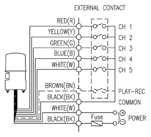

WV ÉùÒôÐźŠ3ch ¶¨×ö²úÆ·
(ÉùÒô¼ÒôÐͲúÆ·£©
ch1
ch2
ch3
MAX 95dB
µçÔ´Ïß
  • µçÔ´Ïß ¹æ¸ñ : UL1015-NO.18(0.75sq) x 2c 400mm
  • AC µçÔ´²úÆ·£º²úÆ·²»Ó÷ÖÕý¸º¼«
  • DC µçÔ´²úÆ·£ººÚÉ«ÏßÁ¬½ÓÔÚ¸º¼«(-)
ÐźÅÏß
  • ÐźÅÏß ¹æ¸ñ : UL1015-NO.22(0.3sq) 400mm
EX)S125D -WS -220 -R
