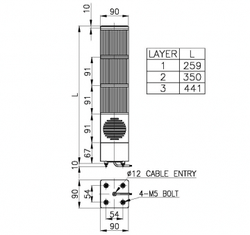

ÍâÐÎÃÀ¹ÛµÄ·½Ðζà²ãʽ¾¯Ê¾µÆ£¬ÊʺÏÓÃÓÚ»ú´²¡¢×Ô¶¯»¯Éú²úÏß¡¢ÎÞÈ˼àÊÓϵͳµÄÒ£¿ØÐźŴ«´ï
  • ·½ÐÎ ë¯µÆ¹Ü ±¬ÉÁÐÍ ¶à²ãʽ¾¯Ê¾µÆ
  • ÄÚ×°È·ÈÏÐÅÏ¢·½±ãµÄÒøÁå°ã¡¢Ã÷Á˵ÄÒôµ÷
  • Ç¿ÁÒµÄÐźÅÉÁ¹â£¬Ô¶¾àÀë´«´ïÐźÅЧ¹ûºÃ
  • µÆ¹Ü²ÉÓýӲåʽ½á¹¹£¬¸ü»»ë¯µÆ¹Ü·½±ã
  • ÒÔСµÄÍâÐÎÄÜ·¢³ö×î´ó 90dB/mµÄ¸ßÒôÁ¿
  • ÊʺÏÓÃÓÚÒ£¿Ø¼àÊÓ×°±¸¡¢ÎÞÈ˼àÊÓϵͳ¡¢»ú´²¡¢×Ô¶¯»¯Éú²úÏßµÄÊÓ¾õºÍÌý¾õÐźŴ«´ï
  • ÉÁÁÁ´ÎÊý(ÉÁÁÁÐÍ) : 60~80/min.
  • µÆÕÖ±ê×¼ÑÕÉ«ÅÅÁÐ (±ê×¼ÑÕÉ«ÒÔÍâÑÕÉ«ÅÅÁпÉÓÉʹÓÃÕßÀ´Ö¸¶¨)
    1²ã :  ºì-R
    2²ã :  ºì-R  ÂÌ-G
    3²ã :  ºì-R  »Æ-A  ÂÌ-G
  • ²ÄÖÊ : µÆÕÖ-AS£¬ÉíÌå-ABS
  • ±£»¤µÈ¼¶ : IP23

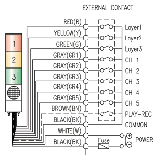

  • µçÔ´Ïß ¹æ¸ñ : UL1015-NO.18(0.75sq) x 2c 400mm
  • AC µçÔ´²úÆ·£º²úÆ·²»Ó÷ÖÕý¸º¼«
  • DC µçÔ´²úÆ·£ººÚÉ«ÏßÁ¬½ÓÔÚ¸º¼«(-)
ÐźÅÏß
  • ÐźÅÏß ¹æ¸ñ : UL1015-NO.22(0.3sq) 400mm
EX)SJD -3 -WS -24 -RAG
