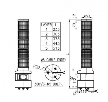

´ø¸ßÒôÁ¿À®°ÈµÄ Ø80 LED ¶à²ãʽ¾¯Ê¾µÆ
  • Íâ¾¶ 56mm ¶à²ãʽ¾¯Ê¾µÆºÍÐźÅÒôÀ®°È×éºÏ³ÉÒ»ÌåµÄ²úÆ·
  • ͬʱ´«´ï¶àÖÖµÄÊÓ¾õºÍÌý¾õÐźÅ
  • ²ÉÓöÀÌØµÄÀ®°ÈÄÚ×°¹¹Ô죬ÒÔͬÖÖ²úÆ·ÖÐ×îСµÄÍâÐΣ¬·¢»Ó¶àÑùµÄ¹¦ÄÜ
  • ÊʺÏÓÃÓÚÒ£¿Ø¼àÊÓ×°±¸¡¢»ú´²¡¢×Ô¶¯»¯Éú²úÏß¡¢´óÐÍÉ豸µÄÊÓ¾õºÍÌý¾õÐźŴ«´ï
  • ±ê×¼ÑÕÉ« ÅÅÁÐ (±ê×¼ÑÕÉ«ÒÔÍâÑÕÉ«ÅÅÁпÉÓÉʹÓÃÕßÀ´Ö¸¶¨)

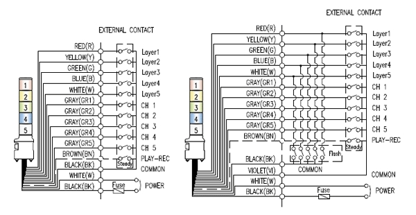

µçÔ´Ïß
  • µçÔ´Ïß ¹æ¸ñ : UL1015-NO.18(0.75sq) x 2c 400mm
  • AC µçÔ´²úÆ·£º²úÆ·²»Ó÷ÖÕý¸º¼«
  • DC µçÔ´²úÆ·£ººÚÉ«ÏßÁ¬½ÓÔÚ¸º¼«(-)
ÐźÅÏß
  • ÐźÅÏß ¹æ¸ñ : UL1015-NO.22(0.3sq) 400mm
