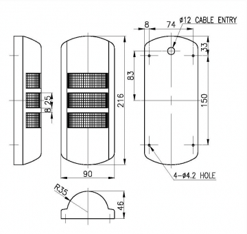

  • 2²ãÐͺÍ3²ãÐ͵ÄÍâÐÎÊÇͬÑù
  • 2²ãÐ͵ϰ£¬ÖÐÑ벿·ÖµÄµÆÕÖÌæ»»³É²»Í¸Ã÷µÄµÆÕÖ
  • ±ê×¼ÑÕÉ«ÒÔÍâµÄÑÕÉ«ÅÅÁпÉÒÔ¶¨×ö

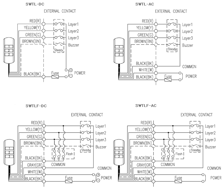

DC ³¤ÁÁÐͲúÆ·
  • DC µçѹ²úÆ· : ºÚÉ«ÏßÁ¬½ÓÔÚ¸º¼«(-)£¬µ«²úÆ·ÄÚ²¿ÓÐÕûÁ÷ÇÅ£¬²úÆ·²»Ó÷ÖÕý¸º¼«¡£
AC³¤ÁÁÐÍ£¬AC/DC ³¤ÁÁ/ÉÁÁÁÐͲúÆ·
  • Òý³ö µçÔ´Ïß ¹æ¸ñ : UL1015-NO.18(0.75sq) x 2c 400mm
    AC µçѹ²úÆ· : ²»Ó÷ֵçÔ´ÏßÑÕÉ«£¬¿ÉÒÔ½»Ìæ½ÓÏß
  • Òý³ö ÐźÅÏß ¹æ¸ñ : UL1007-NO.22 (0.3sq) 400mm
EX)SWTL -(BZ) -3 -220 -RAG
ÐͺŠ·äÃùÆ÷ ¶ÎÊý µçѹ ÑÕÉ«
             SWTL
             SWTLF
ÎÞÖ¸¶¨(None)-±ê×¼ÐÍ
BZÖ¸¶¨(Order)-ÄÚ×°·äÃùÆ÷ÐÍ
               2-2É«
               3-3É«
          12-DC12V
          24-DC24V
          110-AC110V
          220-AC220V
               R-ºì
               A-»Æ
               G-ÂÌ
