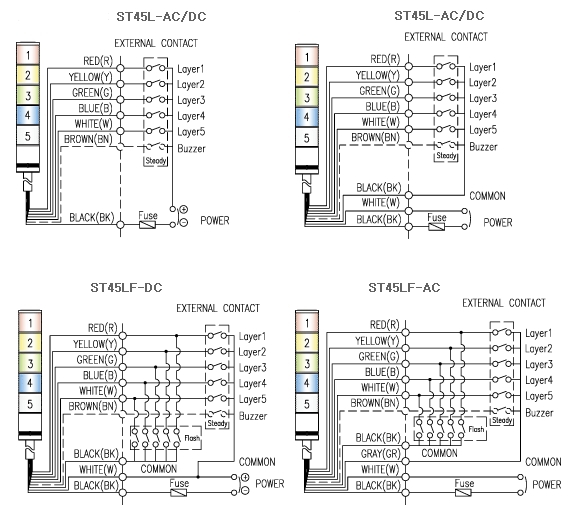

DC ³¤ÁÁÐͲúÆ·
  • DC µçѹ²úÆ· : ºÚÉ«ÏßÁ¬½ÓÔÚ¸º¼«(-)£¬µ«²úÆ·ÄÚ²¿ÓÐÕûÁ÷ÇÅ£¬²úÆ·²»Ó÷ÖÕý¸º¼«
AC³¤ÁÁÐÍ£¬AC/DC ³¤ÁÁ/ÉÁÁÁÐͲúÆ·
  • Òý³ö µçÔ´Ïß ¹æ¸ñ : UL1015-NO.18(0.75sq) x 2c 400mm
    AC µçѹ²úÆ· : ²»Ó÷ֵçÔ´ÏßÑÕÉ«£¬¿ÉÒÔ½»Ìæ½ÓÏß
  • Òý³ö ÐźÅÏß ¹æ¸ñ : UL1007-NO.22 (0.3sq) 400mm
±ê×¼½ÓÏßÒÔÍâ²úÆ·¿ÉÒÔ¶¨×ö¡£

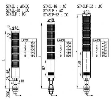

EX)ST45LF -(BZ) -5 -220 -RAGBW -LB18
ÐͺŠ·äÃùÆ÷ ¶ÎÊý µçѹ ÑÕÉ« Ö§¼Ü
         ST45L
         ST45LF
     ÎÞÖ¸¶¨(None)
     ±ê×¼ÐÍ
     BZÖ¸¶¨(Order)
     ÄÚ×°·äÃùÆ÷ÐÍ
           1-1²ã
           2-2²ã
           3-3²ã
           4-4²ã
           5-5단
        12-DC12V
        24-DC24V
        110-AC110V
        220-AC220V
          R-ºì
          A-»Æ
          G-ÂÌ
          B-À¶
          W-°×
      ÎÞÖ¸¶¨-±ê×¼ÐÍ
       LB18
       LW18
       SZ18
       SL18
