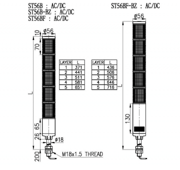

²úÆ·Ãû³Æ£º µÆÅÝ ³¤ÁÁ/ÉÁÁÁÐÍ ¶à²ãÐÅºÅµÆ ST56B
ÐÍ ºÅ£º ST56B
Æ· ÅÆ£º 587
ÊʺÏÓÃÓÚ°ëµ¼Ìå»úе¡¢×Ô¶¯»¯Éú²úÏß¡¢·ÄÖ¯»úе¡¢Ô¶¾àÀë¼à¿Ø
  • ÒÔÖ§¸Ë¹Ì¶¨°²×°ÀàÐÍÊÇ×î¹ã·ºÊ¹ÓõIJúÆ·
  • Ñ¡Óó־ÃÄÍÓõij¤ÊÙÃüµÆÅÝ
  • ¶àÖ̶ֹ¨°²×°Ö§¼Ü¿É¹©Ñ¡Ôñ
  • ÉÁÁÁ´ÎÊý : 60~80/min.
  • ÄÚ×°·äÃùÆ÷ÐÍ ÒôÁ¿ : Max.90dB/m (¿ÉÒÔ¶¨×ö2Òô·äÃùÆ÷ÐÍ)
  • ²ÄÖÊ : µÆÕÖ-AS, ÉíÌå-ABS, Pole-ÂÁºÏ½ð
  • ¼¼ÊõÈÏÖ¤ : CE
  • ±£»¤µÈ¼¶ : IP44 (ÄÚ×°·äÃùÆ÷ÐÍ IP23)
  • ×ó±ßͼƬÊǸ÷²ã±ê×¼²úÆ·µÄͼƬ¡£±ê×¼²úÆ·ÒÔÍâµÄÑÕÉ«ÅÅÁпÉÒÔ¶¨×ö¡£

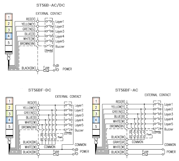

  • Òý³ö µçÔ´Ïß¡¢ÐźÅÏß ¹æ¸ñ : UL1007-NO.22(0.3sq) 400mm
    AC µçѹ²úÆ· : ²»Ó÷ֵçÔ´ÏßÑÕÉ«£¬¿ÉÒÔ½»Ìæ½ÓÏß                                                                      DC µçѹ²úÆ·£ººÚÉ«ÏßÁ¬½ÓÔÚ¸º¼«(-)
AC,DC ³¤ÁÁ/ÉÁÁÁÐͲúÆ·
  • Òý³ö µçÔ´Ïß ¹æ¸ñ : UL1015-NO.18(0.75sq) x 2c 400mm
    DC µçѹ²úÆ· : ºÚÉ«ÏßÁ¬½ÓÔÚ¸º¼«(-)
  • Òý³ö ÐźÅÏß ¹æ¸ñ : UL1007-NO.22 (0.3sq) 400mm
±ê×¼½ÓÏßÒÔÍâ²úÆ·¿ÉÒÔ¶¨×ö
EX)ST56B -(BZ) -5 -220 -RAGBW -LB18
ÐͺŠ·äÃùÆ÷ ¶ÎÊý µçѹ ÑÕÉ« Ö§¼Ü
         ST56B
         ST56BF
     ÎÞÖ¸¶¨(None)
     ±ê×¼ÐÍ
     BZÖ¸¶¨(Order)
     ÄÚ×°·äÃùÆ÷ÐÍ
           1-1²ã
           2-2²ã
           3-3²ã
           4-4²ã
           5-5²ã
        12-DC12V
        24-DC24V
        110-AC110V
        220-AC220V
          R-ºì
          A-»Æ
          G-ÂÌ
          B-À¶
          W-°×
      ÎÞÖ¸¶¨-±ê×¼ÐÍ
       LB18
       LW18
       SZ18
       SL18
