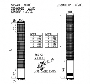

²úÆ·Ãû³Æ£º µÆÅÝ ³¤ÁÁ/ÉÁÁÁÐÍ ¶à²ãÐÅºÅµÆ ST56MB
ÐÍ ºÅ£º ST56MB
Æ· ÅÆ£º 587
ÊʺÏÓÃÓÚ°ëµ¼Ìå»úе¡¢×Ô¶¯»¯Éú²úÏß¡¢·ÄÖ¯»úе¡¢Ô¶¾àÀë¼à¿Ø
  • ÊʺÏÓÃÓÚ°²×°¸ß¶ÈÊÜÏ޵Ļ·¾³ºÍÉ豸µÄÖ±Á¢ÐͲúÆ·
  • ÀûÓÃÌØÊâ·´ÉäÌåÌá¸ßÁ˹âÐźŵĿɼû¶È
  • ÉÁÁÁ´ÎÊý : 60~80/min.
  • ÄÚ×°·äÃùÆ÷ÐÍ ÒôÁ¿ : Max.90dB/m (¿ÉÒÔ¶¨×ö2Òô·äÃùÆ÷ÐÍ)
  • ²ÄÖÊ : µÆÕÖ-AS, ÉíÌå-ABS
  • ¼¼ÊõÈÏÖ¤ : CE
  • ±£»¤µÈ¼¶ : IP44 (ÄÚ×°·äÃùÆ÷ÐÍ IP23)
  • ×ó±ßͼƬÊǸ÷²ã±ê×¼²úÆ·µÄͼƬ¡£±ê×¼²úÆ·ÒÔÍâµÄÑÕÉ«ÅÅÁпÉÒÔ¶¨×ö¡£

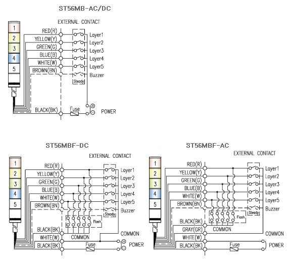

ÐźÅÏßµçÁ÷¼°½ÓµãÈÝÁ¿ (1²ã±ê×¼)
µçѹ ÐźÅÏßµçÁ÷ ³õʼµçÁ÷ Íⲿ½ÓµãÈÝÁ¿ ·äÃùÆ÷ÏßµçÁ÷
                     AD/DC 12V
0.714A
abt.11.0A
Over 12A
0.015A

AC,DC ³¤ÁÁÐͲúÆ·
  • Òý³ö µçÔ´Ïß¡¢ÐźÅÏß ¹æ¸ñ : UL1007-NO.22(0.3sq) 400mm
    AC µçѹ²úÆ· : ²»Ó÷ֵçÔ´ÏßÑÕÉ«£¬¿ÉÒÔ½»Ìæ½ÓÏß                                                                      DC µçѹ²úÆ·£ººÚÉ«ÏßÁ¬½ÓÔÚ¸º¼«(-)
AC,DC ³¤ÁÁ/ÉÁÁÁÐͲúÆ·
  • Òý³ö µçÔ´Ïß ¹æ¸ñ : UL1015-NO.18(0.75sq) x 2c 400mm
    DC µçѹ²úÆ· : ºÚÉ«ÏßÁ¬½ÓÔÚ¸º¼«(-)
  • Òý³ö ÐźÅÏß ¹æ¸ñ : UL1007-NO.22 (0.3sq) 400mm
±ê×¼½ÓÏßÒÔÍâ²úÆ·¿ÉÒÔ¶¨×ö
EX)ST56MB -(BZ) -3 -220 -RAG
