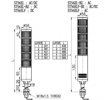

Ø56mm ¾­¼ÃÐÍLED¶à²ãÐźŵÆ
  • ²ÉÓøßÁÁ¶È·¢¹â¶þ¼«¹ÜΪ¹âÔ´µÄ56mm ´ø¹Ì¶¨Ö§¸ËµÄ¸ß¼¶²úÆ·
  • ÊʺÏÓÃÓÚ¸ü»»µÆÅÝÀ§ÄÑ»òÕßÕ𶯼°³å»÷½Ï´óµÄÉ豸
  • ÀûÓÃÌØÊâ·´Éä¾µ¾Û¼¯LED¹âÏߣ¬·¢³öÓëÀàËÆÓÚµÆÅݵÆË¿µÄ¹âÏߣ¬Ìá¸ßÔ¶¾àÀë¿É¼û¶È
  • ¶àÖ̶ֹ¨°²×°Ö§¼Ü¿É¹©Ñ¡Ôñ
  • ½Ó²åʽÉè¼Æ£¬Ê¹¸÷²ãµÆ¿ÉËæÒâ×é×°£¬¸ü»»ÑÕɫ˳Ðò¸ü·½±ã¼òµ¥
  • ÉÁÁÁ´ÎÊý : 60~80/min.
  • ÄÚ×°·äÃùÆ÷ÐÍ ÒôÁ¿ : Max.90dB/m (¿ÉÒÔ¶¨×ö2Òô·äÃùÆ÷ÐÍ)
  • ²ÄÖÊ : µÆÕÖ-AS, ÉíÌå-ABS, Pole-ÂÁºÏ½ð
  • ±£»¤µÈ¼¶ : IP44 (ÄÚ×°·äÃùÆ÷ÐÍ IP23)
  • ×ó±ßͼƬÊǸ÷²ã±ê×¼²úÆ·µÄͼƬ¡£±ê×¼²úÆ·ÒÔÍâµÄÑÕÉ«ÅÅÁпÉÒÔ¶¨×ö¡£
  • ¿ÉÒÔ¶¨×öÔÚÖÜΧ»·¾³60¡æÉÏÄÜʹÓÃµÄ ULÈÏ֤Ʒ(class2, DC24VרÓÃ)

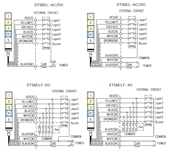

DC ³¤ÁÁÐͲúÆ·
  • DC µçѹ²úÆ· : ºÚÉ«ÏßÁ¬½ÓÔÚ¸º¼«(-)£¬µ«²úÆ·ÄÚ²¿ÓÐÕûÁ÷ÇÅ£¬²úÆ·²»Ó÷ÖÕý¸º¼«¡£
AC³¤ÁÁÐÍ£¬AC/DC ³¤ÁÁ/ÉÁÁÁÐͲúÆ·
  • Òý³ö µçÔ´Ïß ¹æ¸ñ : UL1015-NO.18(0.75sq) x 2c 400mm
    AC µçѹ²úÆ· : ²»Ó÷ֵçÔ´ÏßÑÕÉ«£¬¿ÉÒÔ½»Ìæ½ÓÏß
  • Òý³ö ÐźÅÏß ¹æ¸ñ : UL1007-NO.22 (0.3sq) 400mm
±ê×¼½ÓÏßÒÔÍâ²úÆ·¿ÉÒÔ¶¨×ö¡£
EX)ST56L -(BZ) -3 -220 -RAG -SZ18
ÐͺŠ·äÃùÆ÷ ¶ÎÊý µçѹ ÑÕÉ« Ö§¼Ü
         ST56EL
         ST56ELF
     ÎÞÖ¸¶¨(None)
     ±ê×¼ÐÍ
     BZÖ¸¶¨(Order)
     ÄÚ×°·äÃùÆ÷ÐÍ
           1-1²ã
           2-2²ã
           3-3²ã
           4-4²ã
           5-5²ã
        12-DC12V
        24-DC24V
        110-AC110V
        220-AC220V
          R-ºì
          A-»Æ
          G-ÂÌ
          B-À¶
          W-°×
      ÎÞÖ¸¶¨-±ê×¼ÐÍ
       LB18
       LW18
       SZ18
       SL18
  • µÆÕÖÑÕÉ«¿ÉÓÉʹÓÃÕßÀ´Ö¸¶¨¡£
  • ACÓÃÿһ½ÚµÄÖ±½ÓµçÔ´Á¬½Ó·½Ê½ÊǶ¨×ö¹æ¸ñ¡£
    (½ÓÏßʱµçÔ´Ï߸úµçѹDC²úÆ·(ST56EL)ͬÑù£¬²úÆ·µÄ¸ß¶ÈÓб仯
