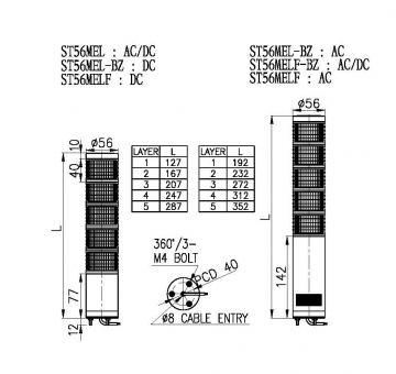

²úÆ·Ãû³Æ£º LED ³¤ÁÁ/ÉÁÁÁÐÍ ¶à²ãÐÅºÅµÆ ST56MEL
ÐÍ ºÅ£º ST56MEL
Æ· ÅÆ£º 587
Ö±Á¢ÐÍ£¬Ø56mm ¾­¼ÃÐÍLED¹âÔ´²úÆ·£¬ÊʺÏÓÃÓÚ°ëµ¼Ìå»úе¡¢×Ô¶¯»¯Éú²úÏß¡¢Ô¶¾àÀë¼à¿Ø
  • ²ÉÓøßÁÁ¶È·¢¹â¶þ¼«¹ÜΪ¹âÔ´µÄ56mm Ö±Á¢Ð͸߼¶²úÆ·
  • ÊʺÏÓÃÓÚ°²×°¸ß¶ÈÊÜÏ޵Ļ·¾³
  • ²ÉÓÃʹÓÃÊÙÃüΪ°ëÓÀ¾ÃÐԵķ¢¹â¶þ¼«¹Ü
  • ÀûÓÃÌØÊâ·´Éä¾µ¾Û¼¯LED¹âÏߣ¬·¢³öÓëÀàËÆÓÚµÆÅݵÆË¿µÄ¹âÏߣ¬Ìá¸ßÔ¶¾àÀë¿É¼û¶È
  • ½Ó²åʽÉè¼Æ£¬Ê¹¸÷²ãµÆ¿ÉËæÒâ×é×°£¬¸ü»»ÑÕɫ˳Ðò¸ü·½±ã¼òµ¥
  • ÉÁÁÁ´ÎÊý : 60~80/min.
  • ÄÚ×°·äÃùÆ÷ÐÍ ÒôÁ¿ : Max.90dB/m (¿ÉÒÔ¶¨×ö2Òô·äÃùÆ÷ÐÍ)
  • ²ÄÖÊ : µÆÕÖ-AS, ÉíÌå-ABS
  • ±£»¤µÈ¼¶ : IP44 (ÄÚ×°·äÃùÆ÷ÐÍ IP23)
  • ×ó±ßͼƬÊǸ÷²ã±ê×¼²úÆ·µÄͼƬ¡£±ê×¼²úÆ·ÒÔÍâµÄÑÕÉ«ÅÅÁпÉÒÔ¶¨×ö¡£
  • ¿ÉÒÔ¶¨×öÔÚÖÜΧ»·¾³60¡æÉÏÄÜʹÓÃµÄ ULÈÏ֤Ʒ(class2, DC24VרÓÃ)

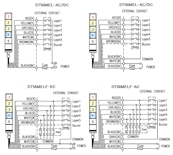

ÐźÅÏß¡¢·äÃùÆ÷Ïß µçÁ÷ (1²ã±ê×¼)
µçѹ AC/DC 12V AC/DC 24V AC 110V AC 220V
ÐźÅÏßµçÁ÷
0.054A
0.036A
0.036A
0.018A
·äÃùÆ÷ÏßµçÁ÷
0.015A
0.028A
0.021A
0.038A
Ãû ³Æ ƵµÀ ÊÓÌý ÒôÁ¿
·äÃùÆ÷ 1Òô PI~PI~PI~Á¬ÐøÒô
MAX 90dB
·äÃùÆ÷ 2Òô
(¶¨×ö£©
PI~PI~PI~Á¬ÐøÒô
PI-PI-PI ¶ÏÐøÒô
MAX 90dB
DC ³¤ÁÁÐͲúÆ·
  • DC µçѹ²úÆ· : ºÚÉ«ÏßÁ¬½ÓÔÚ¸º¼«(-)£¬µ«²úÆ·ÄÚ²¿ÓÐÕûÁ÷ÇÅ£¬²úÆ·²»Ó÷ÖÕý¸º¼«¡£
AC³¤ÁÁÐÍ£¬AC/DC ³¤ÁÁ/ÉÁÁÁÐͲúÆ·
  • Òý³ö µçÔ´Ïß ¹æ¸ñ : UL1015-NO.18(0.75sq) x 2c 400mm
    AC µçѹ²úÆ· : ²»Ó÷ֵçÔ´ÏßÑÕÉ«£¬¿ÉÒÔ½»Ìæ½ÓÏß
  • Òý³ö ÐźÅÏß ¹æ¸ñ : UL1007-NO.22 (0.3sq) 400mm
±ê×¼½ÓÏßÒÔÍâ²úÆ·¿ÉÒÔ¶¨×ö¡£
