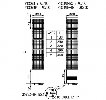

²úÆ·Ãû³Æ£º µÆÅÝ ³¤ÁÁ/ÉÁÁÁÐÍ ¶à²ãÐÅºÅµÆ ST80MB
ÐÍ ºÅ£º ST80MB
Æ· ÅÆ£º 587
ÔÚ¹¤×÷¿Õ¼ä½Ï´óµÄ³¡ËùÔ¶¾àÀëÐźŴ«´ïÁ¦ÌرðºÃµÄ´óÐͶà²ãÐźŵÆ
  • ÊʺÏÓÃÓÚ°²×°¸ß¶ÈÊÜÏ޵Ļ·¾³ºÍÉ豸µÄÖ±Á¢ÐͲúÆ·
  • ÔÚ¿Õ¼ä½Ï´óµÄ³¡ËùÒ²ÄÜÓÐЧµÄ´«µÝ¹âÐźÅ
  • Ñ¡Óó־ÃÄÍÓõij¤ÊÙÃüµÆÅÝ
  • ÉÁÁÁ´ÎÊý : 60~80/min.
  • ÄÚ×°·äÃùÆ÷ÐÍ ÒôÁ¿ : Max.90dB/m (¿ÉÒÔ¶¨×ö2Òô·äÃùÆ÷ÐÍ)
  • ²ÄÖÊ : µÆÕÖ-AS, ÉíÌå-ABS
  • ¼¼ÊõÈÏÖ¤ : CE
  • ±£»¤µÈ¼¶ : IP44 (ÄÚ×°·äÃùÆ÷ÐÍ IP23)
  • ×ó±ßͼƬÊǸ÷²ã±ê×¼²úÆ·µÄͼƬ¡£±ê×¼²úÆ·ÒÔÍâµÄÑÕÉ«ÅÅÁпÉÒÔ¶¨×ö¡£

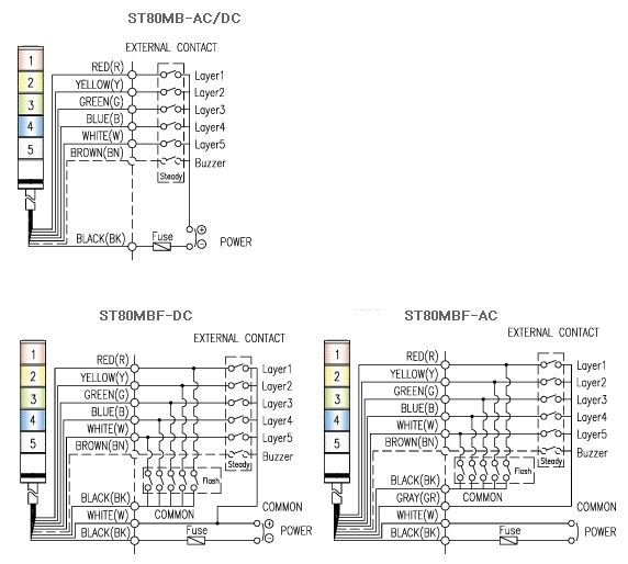

ÐźÅÏßµçÁ÷¼°½ÓµãÈÝÁ¿ (1²ã±ê×¼)
µçѹ ÐźÅÏßµçÁ÷ ³õʼµçÁ÷ Íⲿ½ÓµãÈÝÁ¿ ·äÃùÆ÷ÏßµçÁ÷
                     AD/DC 12V
0.714A
abt.11.0A
Over 12A
0.015A
                     AD/DC 24V
0.370A
abt.6.0A
Over 7A
0.028A
                     AC 110V
0.083A
abt.1.2A
Over 2A
0.021A
                     AC 220V
0.042A
abt.0.6A
Over 1A
0.038A
Ãû ³Æ ƵµÀ ÊÓÌý ÒôÁ¿
·äÃùÆ÷ 1Òô PI~PI~PI~Á¬ÐøÒô
MAX 90dB
·äÃùÆ÷ 2Òô
(¶¨×ö£©
PI~PI~PI~Á¬ÐøÒô
PI-PI-PI ¶ÏÐøÒô
MAX 90dB
AC,DC ³¤ÁÁÐͲúÆ·
  • Òý³ö µçÔ´Ïß¡¢ÐźÅÏß ¹æ¸ñ : UL1007-NO.22(0.3sq) 400mm
    AC µçѹ²úÆ· : ²»Ó÷ֵçÔ´ÏßÑÕÉ«£¬¿ÉÒÔ½»Ìæ½ÓÏß                                                                      DC µçѹ²úÆ·£ººÚÉ«ÏßÁ¬½ÓÔÚ¸º¼«(-)
AC,DC ³¤ÁÁ/ÉÁÁÁÐͲúÆ·
  • Òý³ö µçÔ´Ïß ¹æ¸ñ : UL1015-NO.18(0.75sq) x 2c 400mm
    DC µçѹ²úÆ· : ºÚÉ«ÏßÁ¬½ÓÔÚ¸º¼«(-)
  • Òý³ö ÐźÅÏß ¹æ¸ñ : UL1007-NO.22 (0.3sq) 400mm
±ê×¼½ÓÏßÒÔÍâ²úÆ·¿ÉÒÔ¶¨×ö
EX)ST80MB -(BZ) -5 -220 -RAGBW
ÐͺŠ·äÃùÆ÷ ¶ÎÊý µçѹ ÑÕÉ«
          ST80MB
          ST80MBF
          ÎÞÖ¸¶¨(None)
          ±ê×¼ÐÍ
          BZÖ¸¶¨(Order)
          ÄÚ×°·äÃùÆ÷ÐÍ
               1-1²ã
               2-2²ã
               3-3²ã
               4-4²ã
               5-5²ã
          12-DC12V
          24-DC24V
          110-AC110V
          220-AC220V
               R-ºì
               A-»Æ
               G-ÂÌ
               B-À¶
               W-°×
