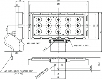

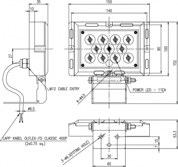

²úÆ·Ãû³Æ£º POWER LED¹¤×÷µÆ QWHL150
ÐÍ ºÅ£º QWHL150
Æ· ÅÆ£º 587
¸ÄÉÆ»ú´²µÄ¹¤×÷ЧÂʺ͹ÜÀíЧÂʵĸßÁÁ¶ÈLED¹¤×÷µÆ
  • ²ÉÓôó¹¦ÂÊ·¢¹â¶þ¼«¹ÜΪ¹âÔ´£¬ÊʺÏÓÃÓÚÐèÒª¸ßÁÁ¶ÈµÄ¹¤×÷»·¾³
  • ²ÉÓ÷ÀÖ¹´ÌÑ۵ľµÆ¬£¬¸ÄÉÆÔÚ¸ßÕնȵĻ·¾³¹¤×÷È˵ÄÊÓ¾õÆ£ÀͶȠ
  • ÂÁºÏ½ðÉíÌ壬¶ÔÕ𶯺ͳå»÷ºÜÇ¿£¬É¢ÈÈЧ¹ûÓÅÐã
  • IP67±£»¤µÈ¼¶£¬ÔÚÇÐÏ÷ÓÍ¡¢·Û³¾¡¢ÇÐÏ÷·ÛµÈ½Ï¶àµÄ»·¾³£¬½øÐÐÎȶ¨µÄ¹¤×÷
  • Ö§¼Ü¿ÉÒÔ·ÖÀëµÄ½á¹¹£¬¿ÉÒÔÑ¡Ôñ°²×°Ö§¼ÜÐͺÍ×ÔÁ¢ÐÍ
  • ²ÄÖÊ : ÉíÌå-AL, Ö§¼Ü-SUS304, ¾µÆ¬-¸Ö»¯²£Á§
  • ÁÁ¶È : 1400Lx at 1m
  • ±£»¤µÈ¼¶ : IP67
Ðͺеçѹ µçÁ÷ ÖØÁ¿ ÁÁ¶È(at 1m) ÑÕÉ«
QWHL150K
DC12V
0.720A
0.93Kg
1400Lux
°×-W
DC24V
0.480A
0.93Kg
  • ʹÓõçѹ AC110V,AC220V ¹æ¸ñºÍºìÉ«¡¢»ÆÉ«²úÆ·¿ÉÒÔ¶¨×ö
  • Òý³ö µçÔ´Ïß ¹æ¸ñ :  VCTF(0.75sq¢ú2C) 400mm
  • AC ²úÆ· : ²»Ó÷ֵçÔ´ÏßµÄÑÕÉ«£¬¿ÉÒÔ½»Ìæ½ÓÏß
  • DC ²úÆ· : ºÚÉ«Ïß»òÕßÀ¶É«Ïß±íʾ¸º¼«(¨C)£¬µ«²úÆ·ÄÚ²¿ÓÐÕûÁ÷ÇÅ£¬²úÆ·²»Ó÷ÖÕý¸º¼«
EX)QWHL150K -24 -W
Ðͺеçѹ ÑÕÉ«
QWHL150K
12-DC12V
24-DC24V
W-°×
