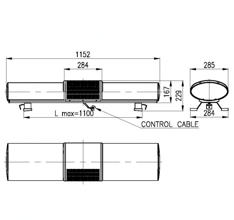

  • ¾¯Ê¾µÆÈ«³¤1700mm²úÆ·ºÍÆäËû³ß´ç²úÆ·ÒѲ»Í¬ÑÕÉ«¶¨×öÌṩ
Ðͺеçѹ µçÁ÷ ÖØÁ¿ ÉÁÁÁ´ÎÊý ÑÕÉ«
               ELV-L          DC12V
 1.85A
 13.4Kg
      60~80/min        À¶-ºì
       ºì-ºì
       »Æ-»Æ
       ÂÌ-ÂÌ
         DC24V
 1.90A
 13.4Kg

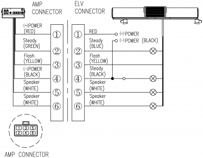

ELV-L -(SPEAK) -12 -B/R
ÐͺŠÒôÁ¿ µçѹ ÑÕÉ«
              ELV-L                   SPEAK                 12-DC12V
                24-DC24V
              B/R À¶-ºì
              R/R ºì-ºì
              Y/Y »Æ-»Æ
              G/G ÂÌ-ÂÌ
