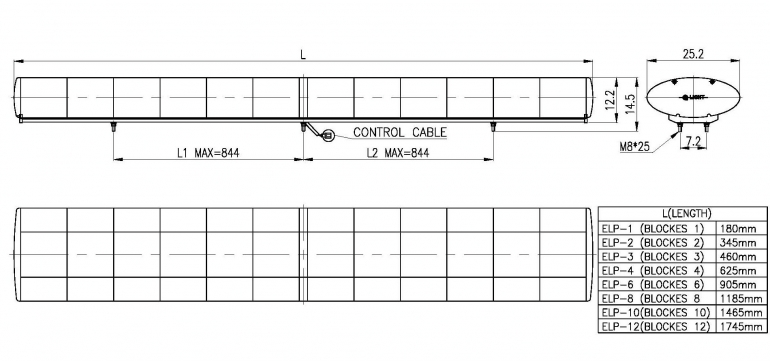

È«³¤Îª´Ó345mmµ½1745mmµÄ³ß´çÒÔ²úÆ·µÄÓÃ;×ÔÓÉÑ¡Ôñ
  • ²ÉÓÃ21W¸ßÁÁ¶ÈÂ±ËØµÆÅÝÌá¸ßÔ¶¾àÀë¿É¼û¶È
  • È«³¤Îª´Ó345mmµ½1745mmµÄ³ß´çÒÔ²úÆ·µÄÓÃ;×ÔÓÉÑ¡Ôñ
  • Éè¼Æ·Ö½â£¬×é×°¼°¹âÔ´½»»»·½±ãµÄ¹¹Ô죬ËùÒÔʺó¹ÜÀíÉÏÈÝÒ×
  • ²ÉÓÃÔëÒôºÍÄ¥Ëð¼«Ð¡µÄÐýת¶¯Á¦´«´ï×°ÖÃ
  • ÊʺÏÓÃÓÚ´óÐÍÌØÊâ³µÁ¾¡¢Ñ²Âß³µ¡¢Í£³µÉ豸¡¢´óÐͳ§·¿
  • ÐýתËÙ¶È : 120~140 RPM
  • ÄÚ×°À®°È£¬ÒôÁ¿ : 120dB/m
  • µÆÕÖÑÕÉ« :  À¶-ºì ºì-ºì »Æ-»Æ ÂÌ-ÂÌ
  • ²ÄÖÊ : µÆÕÖ ¨C PC, ·´Éä¾µ ¨C PC, BOARD ¨C AL
  • ¼¼ÊõÈÏÖ¤ : CE
  • ±£»¤µÈ¼¶ : IP56
  • µÆÕֵĽṹΪ×éºÏÐԽṹ£¬±ØÒªµÄʱºòÔÚÒ»¸ö·½Ïò×éºÏÐÔʹÓá£
Ðͺг¤¶È ÖØÁ¿ µçѹ/µçÁ÷ µÆÅÝ ÑÕÉ«
    ELP-B-2        345mm         2.90Kg    DC12V/2.90A
   DC24V/1.45A
   AC110V/0.31A
   AC220V/0.15A
  12V
  24V
  110V
  220V
           35W15S halogen
           35W15S halogen
           35W15D halogen
           35W15D halogen
  39
  40
  41
  42
      À¶-ºì
      ºì-ºì
      »Æ-»Æ
      ÂÌ-ÂÌ
    ELP-B-3        460mm         4.11Kg
    ELP-B-4        625mm        5.32Kg
    ELP-B-6        905mm        7.74Kg
    ELP-B-8        1185mm        10.16Kg
    ELP-B-10        1465mm        12.58Kg
    ELP-B-12        1745mm        15.02Kg
  • µçÁ÷Öµ¼°ÖØÁ¿Îª1¶Î²úÆ·±ê×¼
ELP-B -4 -12 -B/R
ÐͺжÎÊý µçѹ ÑÕÉ«
              ELP-B                       2
                      3
                      4
                      6
                      8
                     10
                     12
                12-DC12V
                24-DC24V
                110-AC110V
                220-AC220V
              B/R À¶-ºì
              R/R ºì-ºì
              Y/Y »Æ-»Æ
              G/G ÂÌ-ÂÌ
