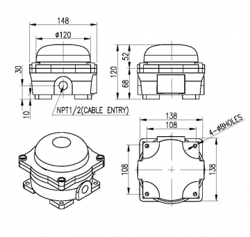

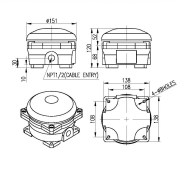

²úÆ·Ãû³Æ£º ·À±¬ÐÍ µçÁå SBE130
ÐÍ ºÅ£º SBE130
Æ· ÅÆ£º 587
ÄÚѹ·À±¬Ð͵çÁ壬ÃܱÕÐÔÓÅÐãµÄ¾­¾ÃÄÍÓòúÆ·
ÊʺÏÓÃÓÚÆøÌåÉ豸¡¢Ê¯ÓÍ»¯Ñ§³ÉÌ×É豸¡¢×ê̽´¬¡¢ÓÍ´¬µÈΣÏÕ³¡Ëù
  • ²ÉÓÃÌØÊâÂÝÏß¹Üײ»÷µÄ½á¹¹£¬ÊʺÏÓÃÓÚ³å»÷ºÍÕñ¶¯½Ï´óµÄ´¬²°»òÕß´óÐͺ£ÉÏÆ½Ì¨É豸ÉÏ
  • ²ÉÓÃÒô´«´ïÄÜÁ¦ÓÅÐãµÄµçÁåÍâ¿Ç£¬¿ÉÒÔ·¢³öàÚÁÁºÍÇá¿ìµÄ¾¯±¨Òô
  • ÊʺÏÓÃÓÚ´¬²°¡¢Ôì´¬³§µÈ³±Êª»òÑηֽ϶àµÄ³¡Ëù¡¢Á¶Ìú¡¢ÖÆ·Û¹¤³§µÈÔÚÖÜΧ»·¾³¶ñÁӵĵط½»òÕßÊÒÍâÆðÖØ»ú
  • ÉíÌå±ê×¼ÑÕÉ« : MUNSELL NO : 7.5 BG 7/2
  • ²ÄÖÊ : ÉíÌå-DIECAST Al, Bell-Steel
  • ƵÂÊ : 400~600Hz
  • µçÁåÒôÁ¿ : MAX. 90dB/m
  • ±£»¤µÈ¼¶ : Exd¢òCT6, IP66
ÐͺŠÄÚ×°Òô µçѹ µçÁ÷ ÖØÁ¿ ÒôÁ¿
SBE130
 BELLDÒô
     DC24V
  0.220A
  2.27Kg
   MAX.90dB
     AC110V
  0.035A
  2.52Kg
     AC220V
  0.018A
µçÔ´Ïß ÒýÈë¿Ú(CABLE ENTRY)
  • µçÔ´Ïß ´¦Àí : Ê¹Ó÷À±¬ÌîÁϺ¯
  • µçÔ´Ïß ÒýÈë¿Ú ¹æ¸ñ : PF 1/2
  • ÒýÈë¿Ú PF 3/4 ³ß´ç¿ÉÒÔ¶¨×ö
½ÓÏß·½·¨
  • AC µçÔ´²úÆ· : ²»Ó÷ÖÕý¸º¼«¡£
  • DC µçÔ´²úÆ· : ºÚÉ«Ïß¶Ë×ÓÁ¬½ÓÔÚ¸º¼«(-)¡£
EX)SBE130 -220
