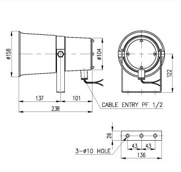

²úÆ·Ãû³Æ£º ÖØ¸ººÉ ÐźÅÑïÉùÆ÷ SEHN25
ÐÍ ºÅ£º SEHN25
Æ· ÅÆ£º 587
²ÉÓøÖÌúÍâ¿ÇµÄÖØ¸ººÉ²úÆ·£¬¿ÉÒÔÔÚÔëÒô´ó¡¢³±ÊªºÍ»Ò³¾¶àµÄ»·¾³Ï¹¤×÷
  • ²ÉÓøÖÌúÍâ¿ÇµÄÖØ¸ººÉ²úÆ·£¬¿ÉÒÔÔÚÔëÒô´ó¡¢³±ÊªºÍ»Ò³¾¶àµÄ»·¾³Ï¹¤×÷
  • ·ÀË®¡¢·À³¾²úÆ·(IP55)£¬¿ÉÒÔÔÚÊÒÍâʹÓÃ
  • ²úÆ·ÄÚ²¿×°ÒôÁ¿µ÷½ÚÆ÷£¬¿ÉÒÔµ÷½ÚÒôÁ¿´óС
  • Óо¯¸æÒô¡¢ÒôÀÖÒô¡¢¾¯±¨Òô ¸÷5Òô¼°ÉùÒôÐźÅ3ƵµÀ
  • ÉíÌå±ê×¼ÑÕÉ« : RED (MUNSELL NO. 5.9R4.4/12.1)
  • ²ÄÖÊ : Steel Housing
  • ±£»¤µÈ¼¶ : IP55
  • ÒôÁ¿ : Max.115dB/m

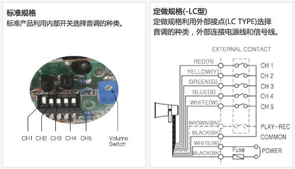

  • Òý³ö µçÔ´Ïß ¹æ¸ñ£ºVCTF(0.75sq¢ú2C) 400mm
  • AC µçÔ´²úÆ· : ²»Ó÷ÖÕý¸º¼«
  • DC µçÔ´²úÆ· : ºÚÉ«ÏßÁ¬½ÓÔÚ¸º¼«(-)
¶¨×ö²úÆ·(-LCÐÍ)Òý³öµçÔ´ÏߺÍÐźÅÏß
  • Òý³ö µçÔ´Ïß ¹æ¸ñ : UL1015-NO18(0.75sq) x 2c 400mm
  • Òý³ö ÐźÅÏß ¹æ¸ñ : UL1007-NO.22(0.3sq) 400mm
EX)SEHN25 -WS -12 -(LC)
ÐͺŠÒôµ÷ µçѹ Ñ¡ÔñÒôµ÷
             SEHN25               WS(¾¯¸æÒô)
              WM(ÒôÀÖÒô)
              WA(¾¯±¨Òô)
              WV(ÉùÒôÐźÅ)
                12-DC12V
                24-DC24V
                110-AC110V
                220-AC220V
              ÎÞÖ¸¶¨(None)
            Ñ¡ÔñÄÚ²¿¿ª¹Ø
             LCÖ¸¶¨(Order)
             Ñ¡ÔñÍⲿ½Óµã
