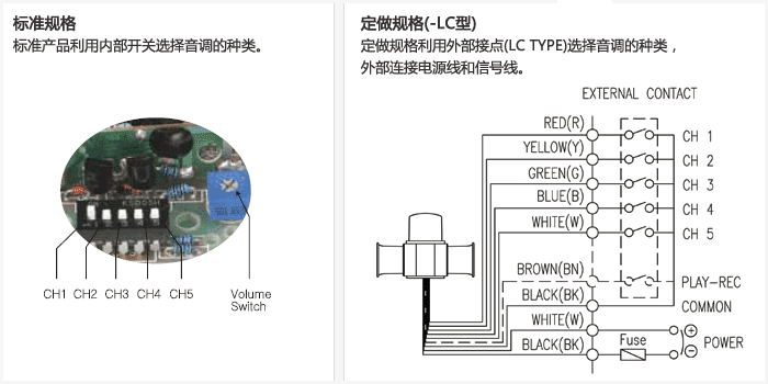

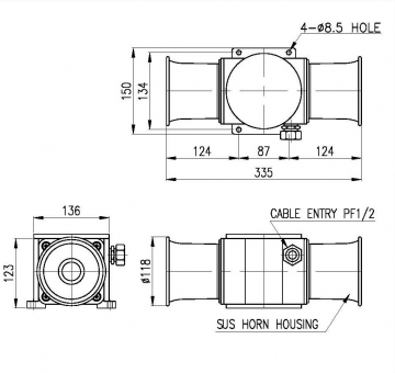

µçÔ´Ïß ÒýÈë¿Ú(CABLE ENTRY)
  • µçÔ´Ïß ´¦Àí : Ê¹Óô¬²°ÓÃÌîÁϺ¯
  • µçÔ´Ïß ÒýÈë¿Ú ¹æ¸ñ : PF 1/2
  • ÒýÈë¿Ú PF 3/4 ³ß´ç¿ÉÒÔ¶¨×ö
½ÓÏß·½·¨
  • AC µçÔ´²úÆ· : ²»Ó÷ÖÕý¸º¼«
  • DC µçÔ´²úÆ· : ºÚÉ«Ïß¶Ë×ÓÁ¬½ÓÔÚ¸º¼«(-)
¶¨×ö²úÆ·(-LCÐÍ)Òý³öµçÔ´ÏߺÍÐźÅÏß
  • Òý³ö µçÔ´Ïß ¹æ¸ñ : UL1015-NO18(0.75sq) x 2c 400mm
  • Òý³ö ÐźÅÏß ¹æ¸ñ : UL1007-NO.22(0.3sq) 400mm
EX)SHDN30 -WS -12 -(LC)
ÐͺŠÒôµ÷ µçѹ Ñ¡ÔñÒôµ÷
              SHDN30               WS(¾¯¸æÒô)
              WP(ÌØÊ⾯¸æÒô)
              WM(ÒôÀÖÒô)
              WA(¾¯±¨Òô)
              WV(ÉùÒôÐźÅ)
                12-DC12V
                24-DC24V
                110-AC110V
                220-AC220V
            ÎÞÖ¸¶¨(None)
            Ñ¡ÔñÄÚ²¿¿ª¹Ø
             LCÖ¸¶¨(Order)
             Ñ¡ÔñÍⲿ½Óµã
