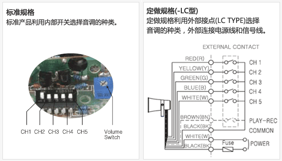

EX)SN -WS -12 -(LC)
ÐͺŠÒôµ÷ µçѹ Ñ¡ÔñÒôµ÷
               SPK               WS(¾¯¸æÒô)
              WM(ÒôÀÖÒô)
              WA(¾¯±¨Òô)
              WV(ÉùÒôÐźÅ)
                12-DC12V
                24-DC24V
                110-AC110V
                220-AC220V
            ÎÞÖ¸¶¨(None)
            Ñ¡ÔñÄÚ²¿¿ª¹Ø
             LCÖ¸¶¨(Order)
             Ñ¡ÔñÍⲿ½Óµã
